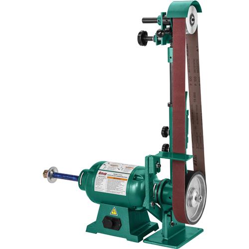

I am just starting to make custom knives, and was wondering what model belt grinder would be best to get. i don't have a huge budget, but any help would be greatly appreciated. links or pictures would also be very helpful.

You really need to clarify your budget. Without that as a baseline we will not know whether or not we should be sending you towards the Coote and or Grizzly or towards the KMG or bader. ALso are you handy, IE can you tap and drill holes if so we might even push you towards the DIY grinder sold by Polarbearforge.com.

my budget is pretty much below $500. I was looking at the polar bear forge and was going to look around and see what people said about its performance. I would say im within the medium skill range for DIY, but i didnt want to buy that just to find out that i lacked the necessary skills.
Check this one out by Grizzly. I know what you mean. I would like a grinder that cost 3000.00 but I would settle for this one just to start out with.
http://grizzly.com/products/G1015
That's a tough budget to get a good grinder on, but it can be done. I'm sure you could find a decent used Grizzly 2x72 for under $500 and it would serve you well.
I bought the Grizzly first for the same reason, price....and while it served me well, I very quickly wanted more. I still have mine and use if for a lot of things, but I bought a KMG fairly soon after I bought the Grizzly.

The good thing about the grizzly is that it also has the buffer. If you get something better later you can use the sander for your scales and the buffer as intended. I think this model cost 524 shipped to your door.
thanks for all of the reply's! can the grizzly do convex grinds and profile blades?
