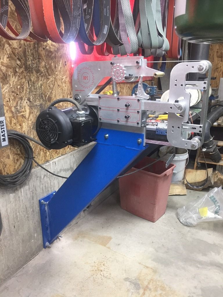

From the Reeder thread-
I've got one and I really like it.
Ginder $500- http://reederproducts.com/products/belt-sander
Wheels $140- https://www.knifegrinderparts.com/c...eel-set-5-drive-5-8-4-tracking-2-idler-wheels
Motor $206- http://www.ebay.com/itm/2-hp-electr...204806?hash=item440404e146:g:hl4AAOSww9xZEhy6
VFD $125- http://www.ebay.com/itm/361155386082?_trksid=p2057872.m2749.l2649&ssPageName=STRK:MEBIDX:IT
$971 for a great setup!
I already had most of the stuff from my DIY grinder but my brothers set theirs up with the above items and they run great. I did add a 7'' drive wheel, I'm running around 6300 SFPM
Here is mine-

Muleskinner222 how is that VFD working for you? Did you have to build a box for it?
