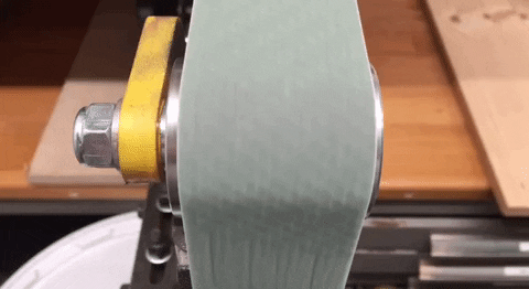

Hi,
I'm just starting out with knife making and recently got a 2" x 72" belt grinder which I just finished setting up and no matter what I do the belts do not run straight but move around 2-3mm left to right.
Here you can see it at three different speeds (15Hz, 60Hz and 100Hz):
I have tried it with different belts (this is a 60 VSM) and it's always the same, so I don't think it's the belt.
Does anybody know what could be the reason?
Thanks, Julius

Is the belt tension tight? If it is not very snug, that can affect belt travel. No binding on the tension arm? This could prevent the tension from remaining constant when the belt is running. Are all the wheels secured tightly to the frame? No vibration? Do any of the wheels seem to have any wobble, there could be a bad bearing in one of the wheels. Is there any debris stuck to any of the wheels? Are all of the fasteners sufficiently tight? Just a few thoughts. The manufacture might have some previous experience to draw from, also.
Try another belt .Sorry ....I read now that you already tried that .Let me think for better advice :)
Well it still looks like it was belt ...Did drive wheel have crown on it ? Maybe tracking wheel and drive wheel are fighting ?
It is hard to tell for sure, but that belt looks like it has rubbed something on the edge? You can see a fuzzy area on the side pass by every rotation. That will make a belt have a slight wobble. Did it go way over and rub the arm while adjusting the tracking?
That might be possible, I will inspect the belt.

I've tightened the belt, and reattached the drive wheel. It seems a little better now:
These Trizact Gator belts should run straight, so I still don't think it's the belt.
I will try some further tweaking tomorrow.

Thoes wabbles are not bad at all. As you gain experance you won’t even notice it. A grinder stiffness will improve wobble or having a static tension system. What I have found is as the belt joint crosses a wheel it pulls it causing a slight wobble. I had a blaze belt with 1/4” wobble and I still used it.
I agree with JT that your wobble isn't significant as long as the belt holds its tracking. I also find VSM belts have a bit more wobble that some others.
sometimes belts wobble when different wheels are fighting each other. One way to figure it out is to remove wheels from the equation or swap them out. try running it without the tracking wheel and see if it lands in the right place on your platten. Try running it in reverse. Try swapping out the idler wheels. Try a different flat platen assembly or contact wheel. these things will help you determine if you do have a problem, how bad it is, and maybe identify the cause.
sometimes the answer is to angle the drive wheel in and out or up and down. Sometimes the tracking wheel needs to be turned in or out. sometimes the platen assembly needs to be shimmed in or out, or is twisted, or the flat platen C plate itself is not straight, or the axles holding the wheels are not straight. The fix is usually easy.
