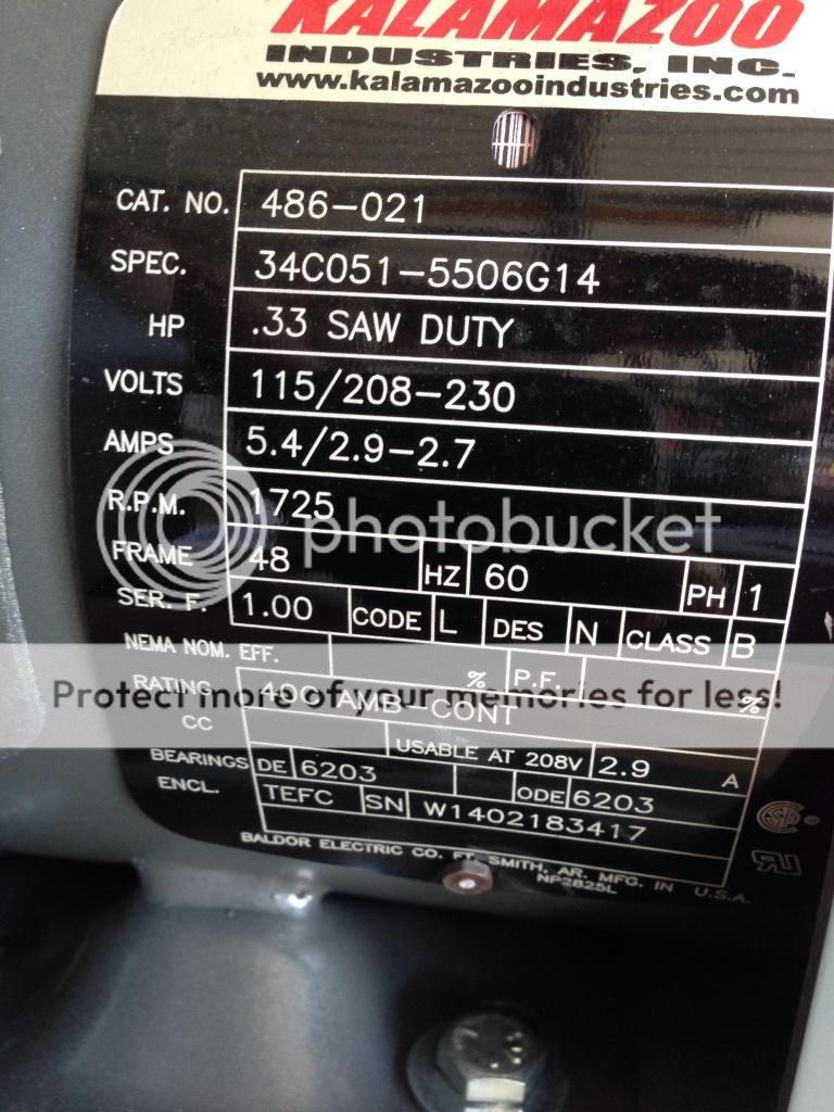

Hello,
Hoping some one can answer this question for me.
I have a Kalamazoo 1x42 belt sander that I use for knife sharpening. It has a 1/3hp 110 motor.
It is getting pretty hot during use. Sometimes when I am sharpening it might run for an hour or so. If I put my hand on the motor I can only hold it there for a second or two.
For comparison, I let my old craftsman bench grinder run for a couple hours and it was barely warm.
I called the manufacturer and they didn't seem too concerned but also said that they would exchange it under warranty if I wanted. I don't want to go through all the trouble to send it back if it is normal to get that hot.
What do you think?
Thanks

Creedmor, I would simply look on the motor of my Kalamazoo, and see what the 'plate' on it said for amperage, and check to make sure that the breaker for that outlet was rated at or above that level. I think you are probably fine, and most household outlets should be fine, BUT.... again some of the guys around here are electrical geniuses and hopefully one of them will see this thread before to long.

Joe, I am just sharpening on it. Very little pressure applied. As a matter of fact, it will get hot just running without being used.
The part on the plate where it says rating 40c ambient class B

Your motor is a class B 80°C rise over the ambient 40°C
120°C = 248°F
More than hot enough to fry bacon and boil tea, but within the specs

So according to that info the temperature of the motor is probably within spec. I don't have a way to measure it but I can put my hand on it for a second or two which makes me think it is less than 248 degrees.
My only question remaining is, is it normal for those motors to get that hot? Could there be an issue either with it's construction or my electric supply?

My guess is running it for a long time with a "saw duty" motor. Saws aren't meant to run for long times. They are made to deliver lots of power for short times. A compressor duty or a continuous duty motor would be better.
I agree with Stacy, the specs and the electrical wiring you said you have make it NOT and issue with current supply or overdraw. I think your motor is OK, but it is just designed for shorter runtimes.
I have never seem a motor labeled saw duty. Are there motor that are designed for saw duty and not labelled that way? Is there a way to figure that out from the motor plate? Thanks
"SAW DUTY" is new to me, also. Here is what I found:
................The Saw Duty rating, means almost nothing. To be saw duty rated for a certain horsepower, a motor needs to hit that horsepower rating for just a very short time period. An example would be a common table saw used to cut through a 2X4 stud. It does not have to be able to maintain it without overheating or shutting down at all. It just has to hit that horsepower for that second. With these motors it is hard to tell what you are getting. They are usually lower cost, lighter duty motors. They may or may not perform well ..................

I had never heard of that term either even though it was on plate. After a couple folks here pointed it out I did some research on it. Mostly negative opinions that I read.
Another term that I read up on is service factor see the link. http://www.fele.com/franklin-aid/just-what-is-a-service-factor.aspx
This motor (if I understand it correctly) has a minimal service factor also.
