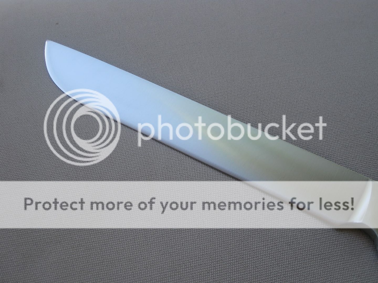

Hmm. Leaning towards the Kalamazzo then. What do you mean by smooth out the grind? Sharpen the factory convex? Change the profile if I wanted to? Typically the tasks you mentioned would be the ones performed most often.
You could use it to give it a full zero edge convex and a nice satin finish. You could reprofile it and do overall finish work/touchups on the blade and handle. I used mine to reprofile this B11 to have a zero convex edge then I used scotch brite wheels to give it the final satin finish.
Sorry for the crapy pic.
I said it before J, but sick work. If I didn't know better I would say it came from the custom shop.
