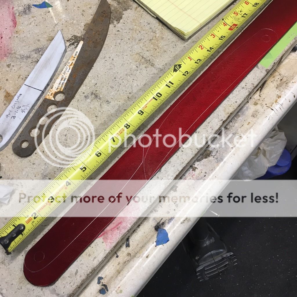

I sent Ben a nice bar of Vinland pattern Damasteel for the project and he just sent me the photos of the beginning of the build. There was enough Damasteel to also make two of his OSS daggers in different sizes.

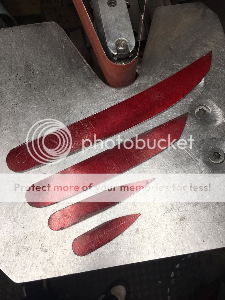

Progress....
Surface grinding the profiled blades.

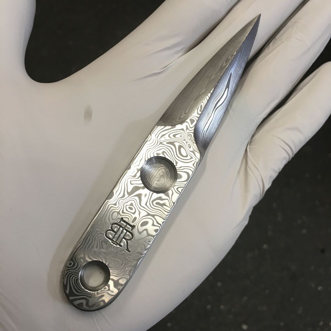

Polished and ready to etch.
Strong acid, means etching outside. This is my first time ever working with damasteel, so it's a learning experience along the way.

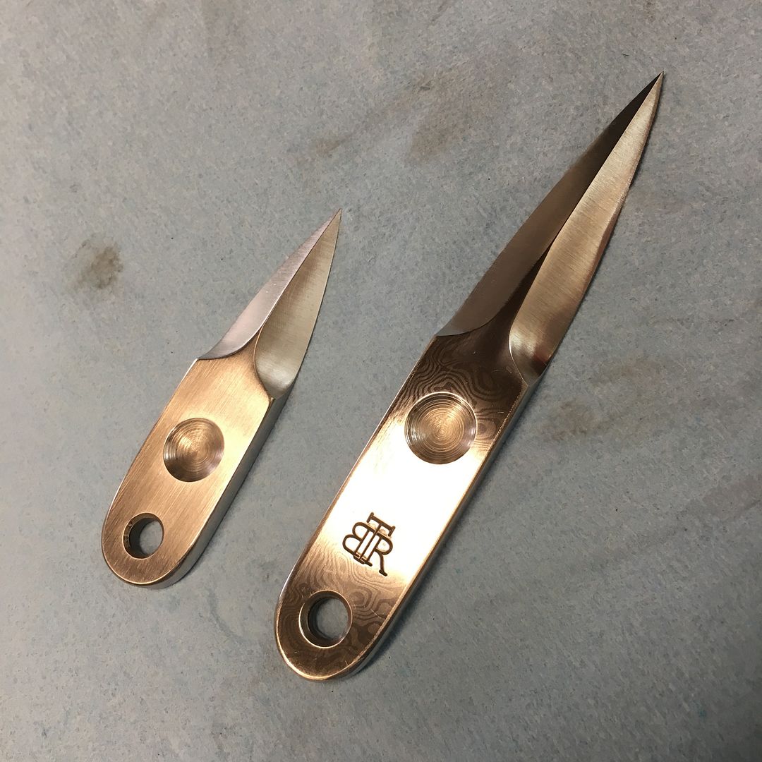

On to finishing the kwaikens. Swedges finish ground.

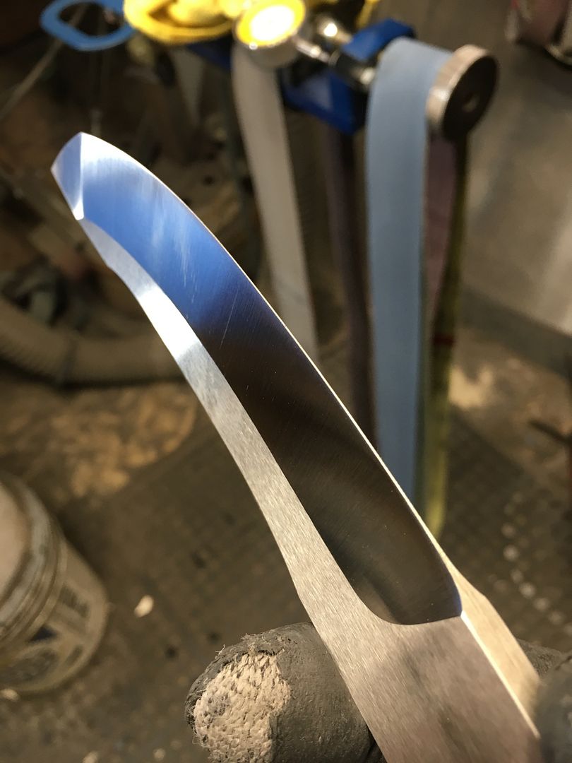

Finishing the bevels. These are super tricky to keep all the bevel intersections crisp on these. Even more so at higher grits.
Deep DC marking my logo before I etch the blade. This worked very well.

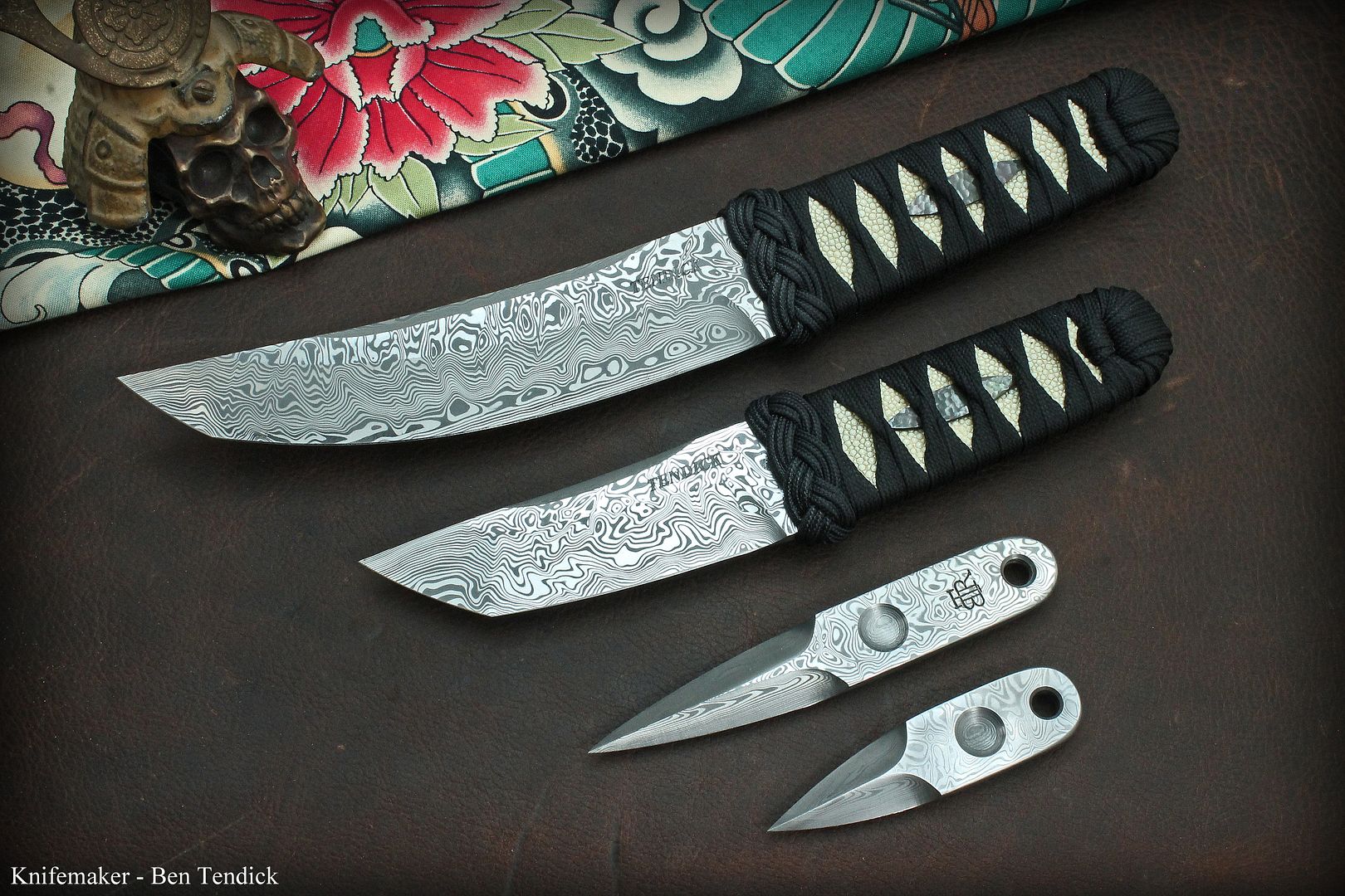

Here is the 6" kraiken ready to wrap. I can't get over how clean this steel is. Just unreal.
Those make a phenomenal set my friend....that Damasteel gets SHARP, too.
