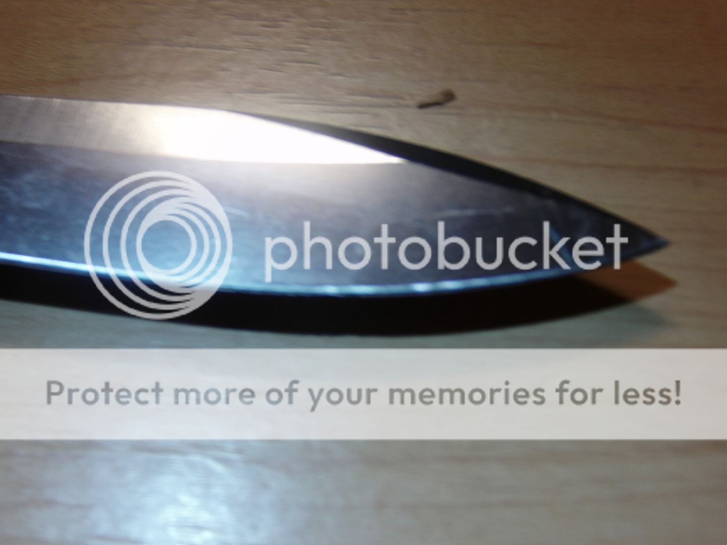

first of all i wanna say yes, im stupid for flipping on concrete. i was so excited when i got my new balisong it never leaves my hand...including when i go out for a smoke, still flipping :/ yesterday i was flipping, and looking back on it, im an idiot for trying aerials on concrete, but the blade smacked edge first on the ground and now it needs to be touched up. its not extremely bad, but bad enough. it feels like theres burrs on one particular spot and if you look closely one part by the belly of the blade is pretty rough.
my question is can i fix this up by just sharpening it up again or do i need to use my diamond stone then my arkansas stone, or more work than that. i know how to sharpen knives but i dont wanna screw this up more than it already is...its d2 steel too btw

Whatever you do, you're going to have to keep doing it until the ding is gone. Simple as that. Diamonds would be preferred since they'll cut faster. A belt sander would probably do you even better, if you have one and know how to use it.

Yep, it's a pain but I've got deep chips out of S30V (I think BM D2 is easier than their S30V) using diamond rods on a SharpMaker and 100x's faster with an x-coarse DMT Diafold (medium pressure strokes). You might pull off the D2 with just a coarse diafold, depending on the edge.
Be more careful - but I doubt you need that advice right now. Sharpen 'em out and you'll be ready to rock n roll again. ;)
Got any pics for us?
yeah sorry about that...i was gonna post a pic but i wasnt sure if it would be much help..heres the pic:
im not sure if you can make it out but if you look closely, towards the belly you can see a lil bit of the jagged edge. im not too sure if itll make that much of a difference to the blades edge, but i started to resharpen it SLOWLY. this is my first knife over 100 and im sure its not that big of a deal to some but a 200+ dollar knife having chips in the blade is a scary thing especially when its my edc/tactical blade lol

That'll sharpen right out of there real easily if you do a little sharpening. Not nearly as bad as I had in mind last night. ;)
as cziv said, no problem...

looks like you'll be fine going at it with a coarse stone and going up to a finer grit once the edge is restored.
