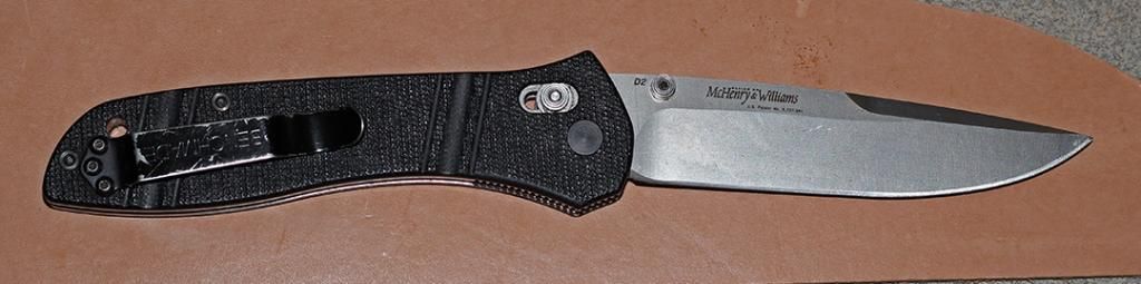

The recurve had to go...
...so it did. Much better now.
