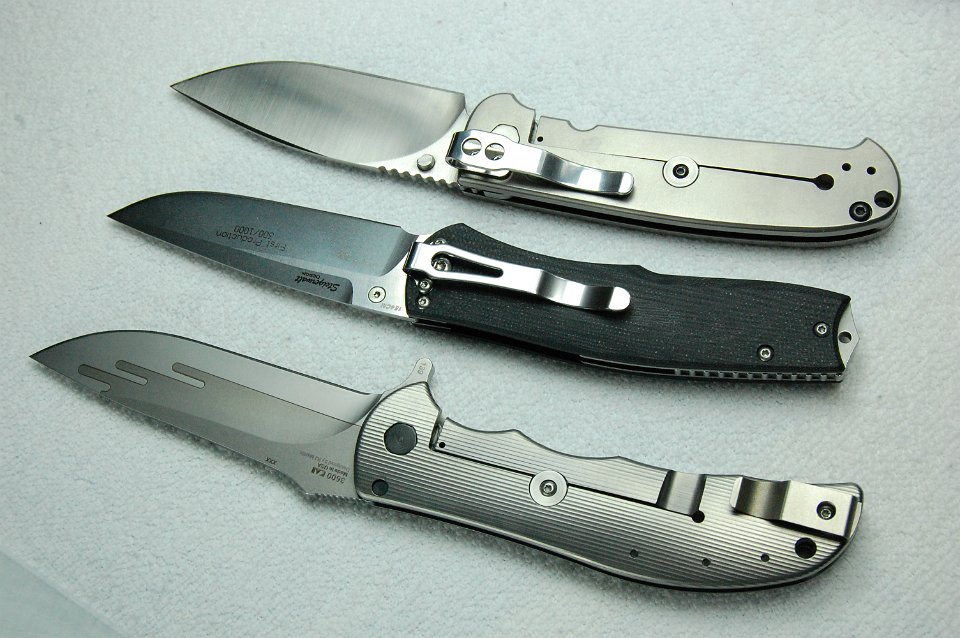

Here is a picture of mine just because.
Best of luck with your knife, and please post pictures when you have a chance.

Here is another picture of mine -
and a link to all the pictures I have taken of this one:
http://www.iammoon.com/albums/knives/Benchmade/890 torrent NITROUS/index.html
