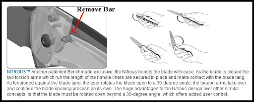

The 913 an Assited Opener, and I don't like AO .
I have heard of this AO accidently firing in a pocket.
Easy enough to remove the AO wing bar, just becomes a smooth manual liner lock.
Flicks open just as fast and a heck of a lot easier to close.
I'm surprised more folks don't try this (removing the AO bar).
As a manual, it is on par with a large CRK Sebenza.
