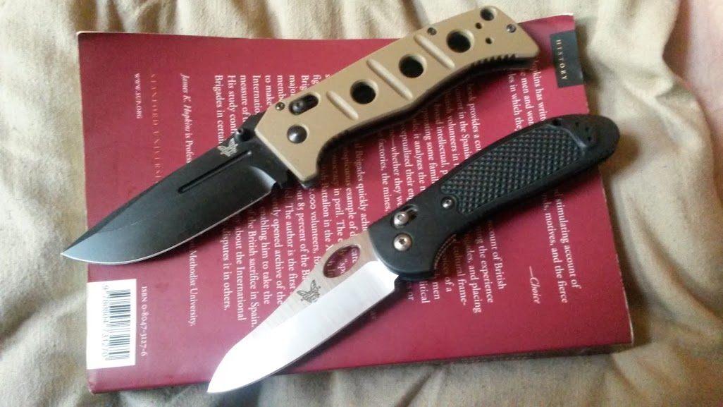

The Griptilian is pretty tough for its weight, with the thinner blade it will slice (cutting deep enough the blade passes through the material), fits medium size hands well.
The Adamas' blade is nearly twice as thick, the AXIS lock 25% larger = stronger, its noticeably heavier, I think the handle is more comfortable, I think it fits large size hands better. It will take longer to sharpen, not because D2 is extremely difficult to sharpen, but because the blade is thicker, you will have to take off more steel to get it to a 30 degree (or whatever your preferred angle of sharpening/reprofiling) so it'll just take awhile longer, but won't be overly difficult.

I've had a Grip early on and sold it. It was, and is, a nice knife. It is not, however, in the same category as the 0275 Adamas. This knife is big, heavy, and probably indestructible under "common" usage. Heck, you could beat on it and it would likely still hold up longer than you could. I have two of the Adamas, the original black and a newer tan, and I'm very impressed.

I've got both and they are excellent, although quite different in some aspects.
The Griptilian is much lighter than the Adamas, and so carries better in thin fabric pants. The blade is also thinner, with a higher grind, so it slices better. It's a good jack of all trades, it will flex into many different roles and do almost anything you might need a pocket knife for.
The Adamas is a lovely design, smooth as butter and with a fantastic feel in hand (I have big hands). It's very tough, but since it's thick and heavy it doesn't fit into some pants very well (think dress pants and so on). It does cut well, but the blade and grind are thick.
