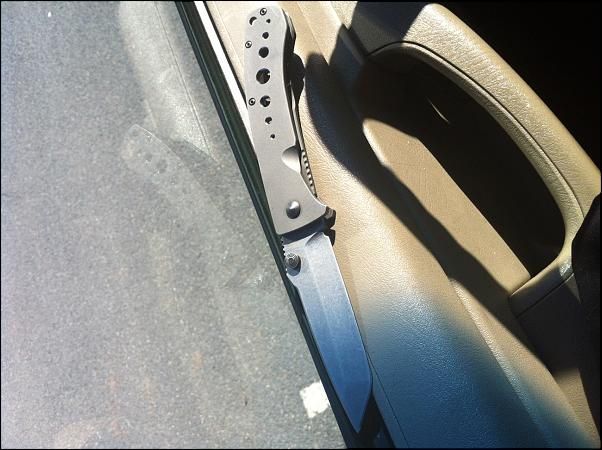

An update since earlier post I made withing this post. I got one in March 2012 and so far so good, no stop pin problems and I believe mine may be resting on one of the "flats" on the pin. I haven't used it long term but I've certainly been using it hard and often and it's as tight as the day I got it. I friggin love this knife.
Good to hear :thumbup:
Ive read many complaints about the weak detent, but some report that it was possibly fixed on later versions. Hows the detent on yours?
BMLFTi.jpgThe detent on mine is good, not weak and not too strong. It's not going to open accidentally from what I can tell. I haven't tried an inertia opening and don't do those anyhow. Been contemplating tapping it for tip up carry but have gotten used to tip down. IMG-20120424-00058.jpg
