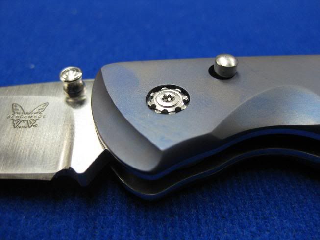

There are a few things I want to address that weren't brought up. The lock and the anodized Ti.
You can see some discoloration in the scales from nice blue, to gray. I'll get to why in a little while.

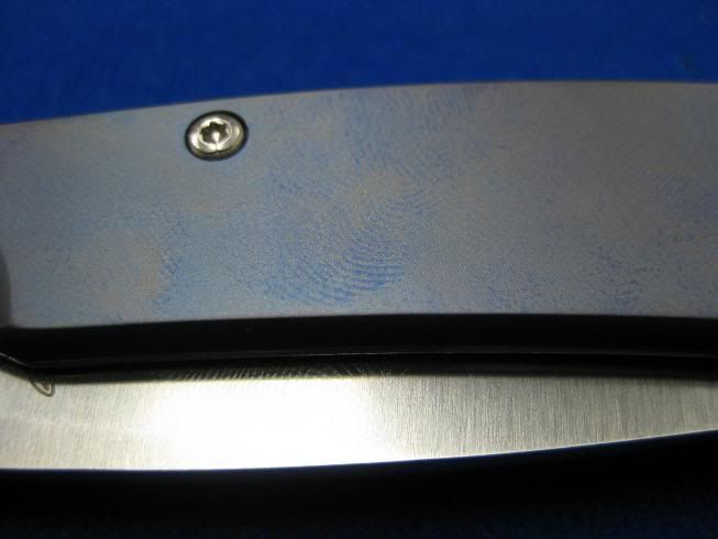

Close up example of how the color changes. This color change is due to how the Ti is colored. To anodize Ti, you put it in a chemical bath, and run a current though it. Depending on where the current is, you get a specific color. Benchmade did a GREAT job making sure that only one solid color shows up (not an easy task). This color is a coating on the Ti that just reflects that color.
Grease (read: finger prints), water, and anything else will make this a dulled out or different color. In the case with this knife, gray.
Luckily it's fairly easy to clean with just some soap and water.

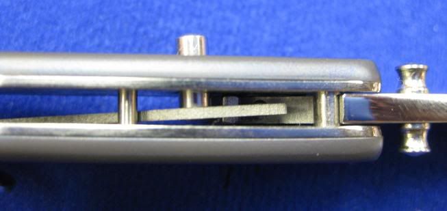

The lock to me, acts like a Spyderco Compression lock. The only issue I've had with the Nak-Lok, was that it took quite a bit of force to move over. The knife I played with didn't have that issue here, and worked great.

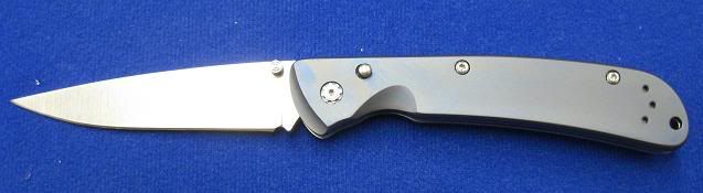

Good knife. I like the idea, but the graying of the Ti scales from just touching it bugs me. when cleaned, it's a VERY striking knife. I just forgot to take pictures of it.
