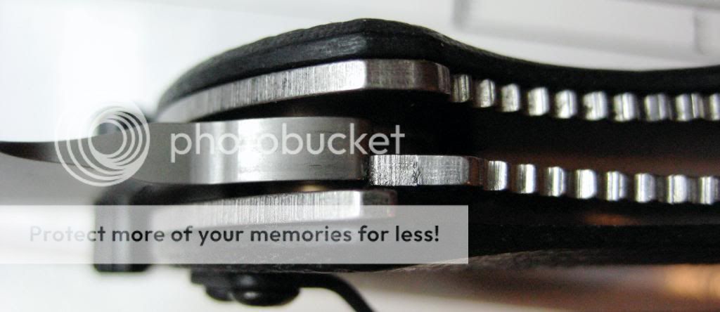

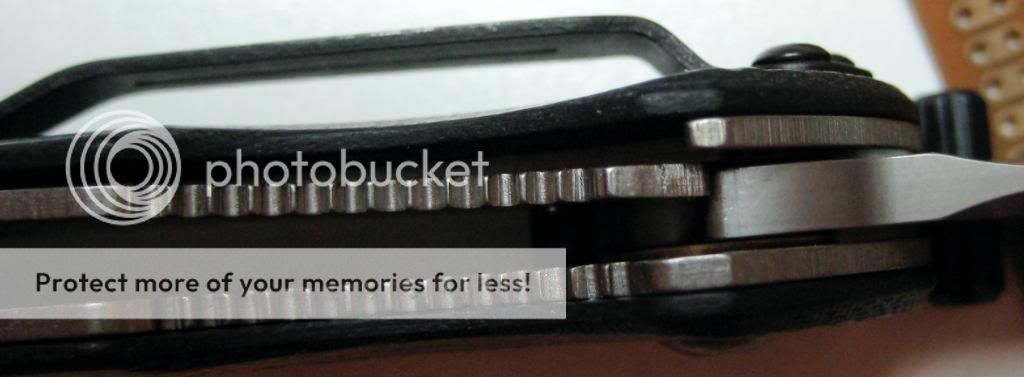

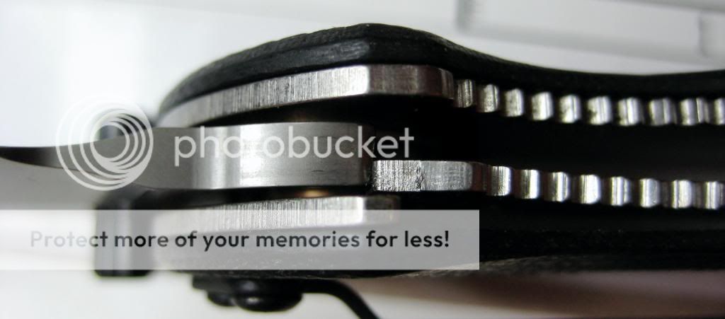

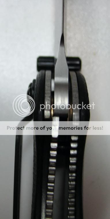

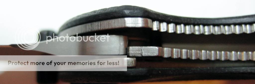

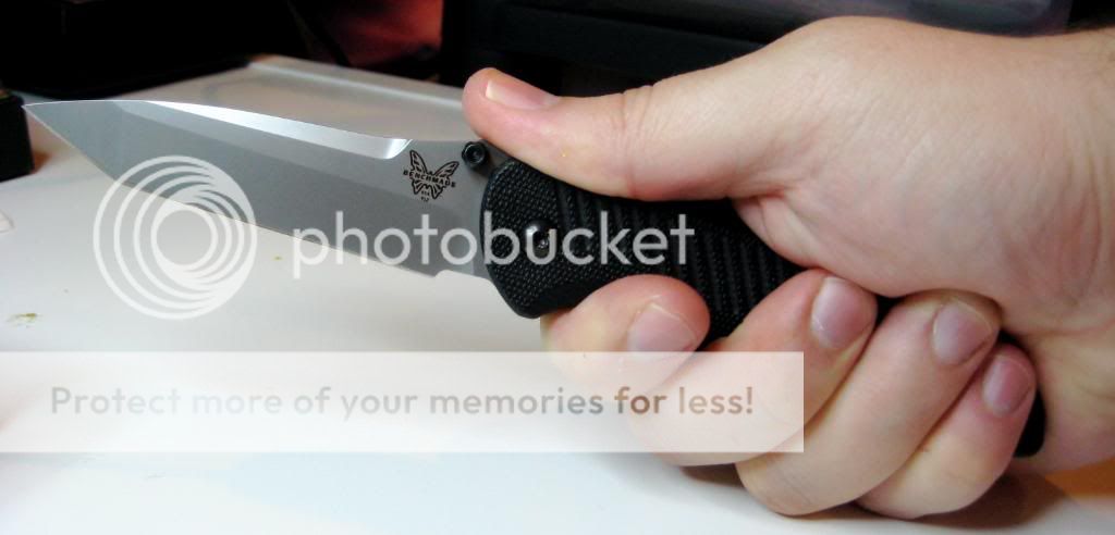

Hi All,
I was holding my week old Nitrous Stryker 912 and for the second time since I've had the liner lock has opened up on me when I didn't want it to. Basically happens if I grip it very strongly like the first picture below. I can easily make it open up with my grip with a little wiggle of my pointer finger, but I certainly wasn't trying to during those first two times.
So I'm not sure what's going on, am I holding the knife badly, is this particular lock defective or is this a bad design? Seems like regardless of how I hold the knife my finger would be right inline to disengage the lock.
Other then this I really like the knife, of course that's kind of like saying I really like this car but the brakes don't work. ;)
First time taking close up photos so if they are bad I'll take any hints on making them better.
That's weird, in a lot of those photos it looks like you can't unlock the liner.
What you're describing is the nature of liner locks. Most can be unlocked by whittling wood and twisting the blade to pop off shavings for example. I have not handled this particular knife so I don't know how easy it is to do on that design. Some are better than others in this regard.
I think that's just the angle of the pictures, the thing unlocks very easily which I think is the problem.

Also, from the pics, it seems that your lock bar does not have a full arc. Mine has a nice even bow, the full length of the bar. Does that make sense? Looks like yours is kind of straight right in the jimping. ? On a spine whack test, that straightness could make the bar slide off the tang of the blade.
Mine had a similar issue when gripped with even moderate force, so I took it apart, peened the end of the liner lock a bit to lengthen it, and now it locks up great!
Voids the warranty, but it works like a dream now.
