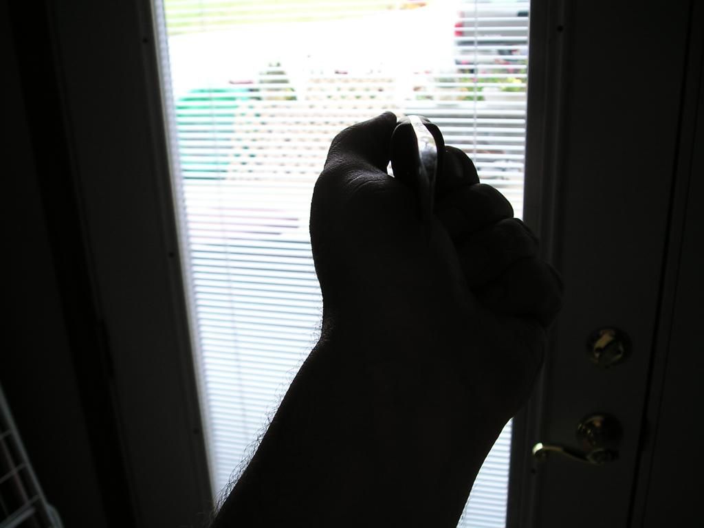

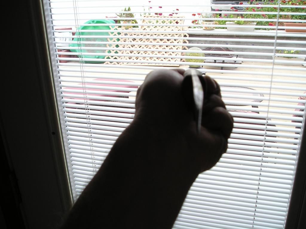

I recently aquired a BK16 on another forum and must admit it's one of the best fitting/feeling knives I've had in the hand, light yet stout and extremely utilitarian. It did have some modding on the blade (strip, etc) done but did notice a very distinct bend in the top 1/3rd of the blade. I doubt Kabar does any sort of repair work and really would like to keep this knife and not be swapped out as I have my doubts that I would get a saber ground version back in return (if this is even covered under the warranty). After I e-mailed the individual I got it from he believed he was being overly critical as he noticed the same thing but didn't mention it but I could see how many average users may have not picked it up. I have had obtuse grinds especially near the tips of blades but never seen a blade slightly off center like this before. I e-mailed Kabar to see if something can be done but would there also happen to be anyone out there that has the means of straightening a blade? I would appreciate any feedback on this, thanks!

is it roll stamped? could be why...

Yep, only way that I'd see that happening in normal manufacturing was back when they roll stamped things. The roll stamping process put tons of pressure on one side of the blade, and sometimes things got bent a bit. My BK2 has a slight bend in it from this.
If its a Laser engraved one, I have no idea how that would happen.

don't confuse taper with bend. try both sides. if they look the same, it's taper. can't go from N to N/2 to N/4 thickness without some changes in apparently width.
and nope, no concerns are warranted. if you HATE it, contact KaBar

A vice would have broken it, well, maybe. I've done that to a few of the BK14's that were bent, tried to find an at home method of straightening. If anything, it will be put in a straightener, or you will probably get a new knife.

Thats funny you mention 10 days is the typical turn-around Moose, a FFG model just arrived UPS but was amazed to see the letter inside stating "our warranty only applies to the original purchaser of the knife only also any modification (in this situation just paint stripping) voids the warranty. They did swap it out and kept the Sabre ground version though. OK, trying to post the pics of the bend (hope this works), more distinct in one of these pics.
