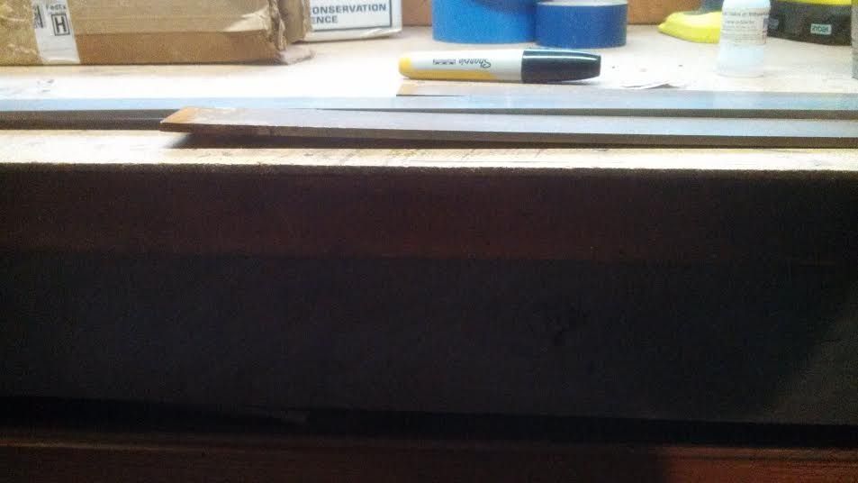

all 3 bending in different directions to each other. front one at the ends, middle one in the middle, back one least of the 3 but ends as well.
3 lengths of 48" some better than others. Based on other threads this seems fairly common. Is it bad enough that i want to start straightening or cut it up in blanks first and then try or not even mess with it?
Only equip i have is small hammers and 6" of railroad track.
PHoto doesn't show, but I'd think cut up into blade lengths and straighten then.
Ken H>
photo up now. yeah i really wanna rip into this but i'll wait until i get a better idea of the correct approach.
I got some .070" stock from Aldo recently that had a lot of twist and a little curve. They advised me that when you cut it into pieces there will be some kind of tension released that will let it un-warp.
So that's what I did. It might have helped, though on a 6" blade the amount of twist wasn't too noticeable either. And what twist there was got mostly ground off anyway. But that slight curve bugged me and once I start trying to straighten something it seems like I never stop, it just gets worse and worse. I'd rather start with something perfectly flat, if possible.
Yes, its something that happens regularly and I think if you want to make knives with regular bar stock , learn to deal with it as you get it. If you have a large vise, stick the bent end in it positioning the bar so that the bend is about level with the vise jaw. Now take the far end and pull on it just a bit to see what is happening and go from there with more or repositioning the bar if you think it will help. No large vise? I then suggest you prop up the bar with a thin piece of metal and give it a hit with a hammer. Bar stock is usually very easy to bend. Returning only means the next time or from the next place might bring you more of the same.

Making knives requires knowing how to work metal. Having steel arrive bent should not be a major concern. If you are limited in the tools you have look to leverage for your advantage. If you can get most of the bend out by using the length of the steel bar as leverage against itself then do that. A good strong vise and a long length of black pipe in a diameter that fits over the end of your steel bar can be helpful. Putting the bar on the floor with a block of wood or other device as a riser under the ends of the bar and standing on it can work too. The best thing I have found so far is getting a cheap shop press from Harbor Freight. I cut the bar to the length I need for the blade then use the press to carefully work out all the bends and twists.

I have straightened out steel by placing on a table saw table to see where the bend is, then using a rawhide mallet with the steel on a steel block, I straighten. Sometimes the steel is bent and also twisted. This causes more problems. In that case I use a vice to hold one end of the steel and a pipe wrench to straighten.

What type of steel is it?? If it is in the annealed state you should be able to straighten it cold. It is always good to to do at least a normalizing cycle anyway. If it is 1095 from Pacific they shear it from a larger plate. That may be why it is bent. If you have problems getting the kinks out let me know and you can come down and we will put it in the forge.
The only time you'll ever be guaranteed to get truly straight and flat stock if is you're buying precision ground stock. Most tool steel bars are cut from sheet, and those sheets are formed in ginormous rolls, and they almost all have some curve or bend to them, particularly thin stock.
