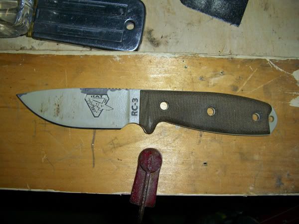

Start:
Middle:
End:
In its present condition (after being beaten up for about a year since the mod):
:cool::thumbup:
My Izula:
Project is complete. I use Marhydes "Tal-Strip" and it worked great. Two applications of about 10 minutes each, scrape the paint away with some steel wool, and a nice bare blade presented itself.
I hit the blade with some coarse, medium, and fine abrasive pads to create a nice satin gray color.
Reprofiled the edge a bit and used a bit of vinager to protect the blade with a patina. I'm very happy with it.
No counting the sharpening, about a 45 minute project.
