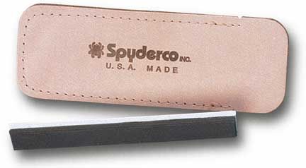

Spyderco double stuff sharpener or small DMT flat. They are light and effective. But I also don't use serrated edges in the field.
Item: 303MF
Description: SC303MF SPYDERCO DOUBLE POCKET STONE FINE/MEDIUM
Spyderco Double Stuff Pocket Stone. Measures 5" x 1" x 1/4". Fine grit on one side, medium grit on the other. Comes with leather storage case.

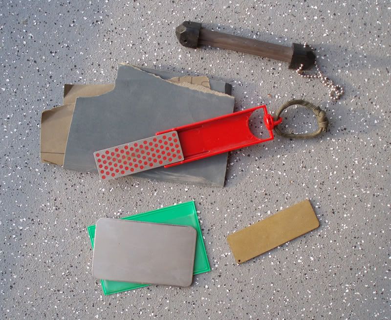

You can wrap the paper around a stick to create a sharpening rod, or hold it flat on a harder surface to make a 'benchstone'.
I used all of these, and sandpaper is the way to go for me nowadays..
Gatco dogbone
3M wet&dry 1200 grit
DMT folding pocketsharpener ( very good!)
DMT creditcardsharpener
Fällknivens D3T sharpener (excellent!)

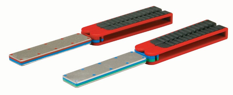

I carry a pair of DMT DuoFold pocket sharpeners in my back pocket next to a Spyderco Military. One is X-Coarse/Coarse, the other is Fine/X-Fine. The extra length over the DMT keychain sharpener is a big advantage, especially on longer blades. The four grits let me do anything from a quick touch-up to restoring a completely trashed edge in the field.
If carrying two sharpeners is too much, a Coarse/Fine DuoFold will take care of most field sharpening. It just takes a little longer to remove edge nicks and doesn't produce as fine a finish.
