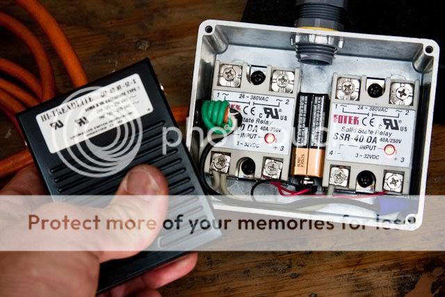

I bought most of the parts. I'm going to try to make a sealed box that has external heat sinks; that can be plugged into the end of the power cord for momentary power, or removed for constant on/off. I'll share the project here.
It's going to be a while because Amazon tried to get me for $45 shipping on $90 worth of light parts. Now most of my parts are coming direct from China with free air freight.
Most of the parts showed up early this week - even the SSRs direct from Hong Kong, lol.
I went out and picked up a few things today - some cable clamps, heat sink compound, a 9 volt connector, plugs, etc. Although I want to make two of these, I decided to start with one first to see how it went.

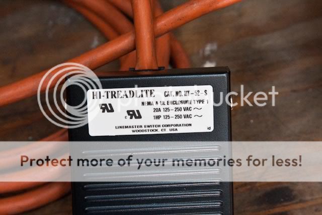

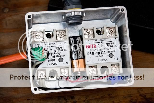

I pretty much did what Stacy said for a solid state relay footswitch that can handle high voltage but only has 9 volts on the floor (under my water bucket, so that's good). I wanted something that would be easy to use or bypass when it was not necessary. I also wanted it somewhat sealed, but since heat is an issue, I used the heat sinks on the outside of an aluminum project box and used heat sink compound between the SSRs, the box, and the heat sinks to ensure good conduction and hopefully heat dissipation.
I got the solid state relays with heat sinks from Hong Kong, the footswitches and the aluminum boxes on Amazon and the connectors and misc stuff from Home Depot and Radio Shack. The 12/3 wire and the 14/3 wire are parts of extension cords.
This thing works. I've only tested it, time will tell how it holds up.
Here is the low voltage wiring.

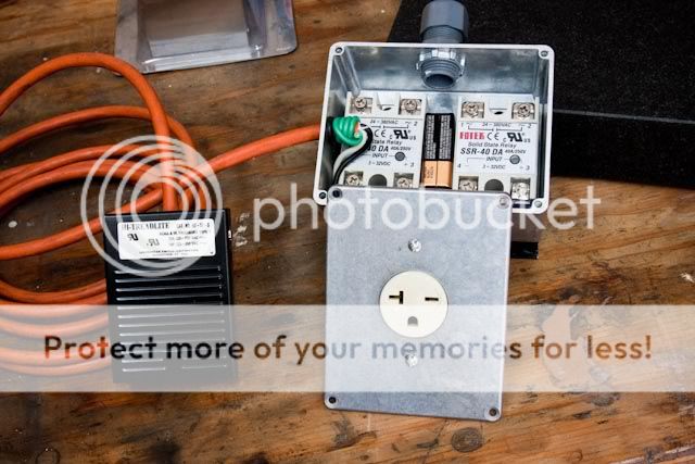

Testing the relays. Notice the indicator lights.
I mounted the outlet in the cover.

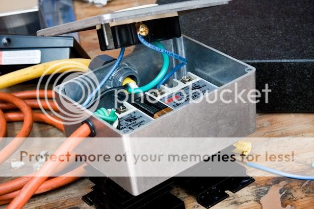

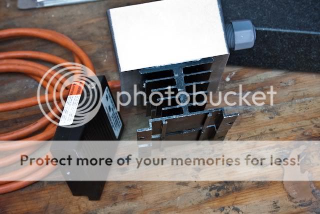

A shot of the heat sinks.
High voltage in.
Close up of the switch.
Complete unit.
Thank you again, Stacy. If this thing holds up, it's going to be awesome.
Erik
