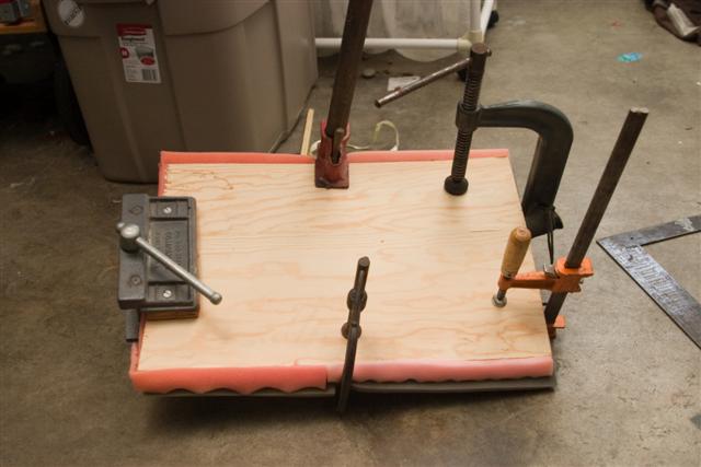

I was thinking of trying this as there are a few things I'd like to sheath. However it looks like you need considerable investment for things such as the rivet press and kydex press.
I'm pretty sure I can make a kydex press out of aluminium scrap from work, but the rivet press is something that is currently beyond me :(

I made my Kydex press out of plywood with foam attached with spray glue. I clamped the pieces together with a wood vise, c-clamps and pipe clamps (that was what I had available, 4 large C-clamps would do the job). I didn't buy a rivet press, instead I used standard aluminum 'pop-rivets', the rivet gun was relatively cheap, and I can use it for other household purposes.
