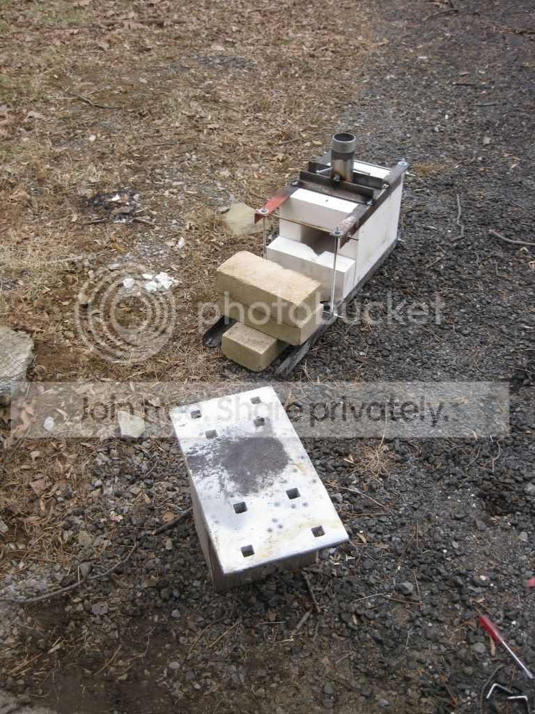

Here's mine, its a 9 brick forge i think. i built the burner for cheap, the most expensive part was the propane regulator at $70. i think all in all i have maybe $150 wrapped up in it. I would wrap it in steel if i were to rebuilt/revamp it as the bricks are VERY brittle. Still needs some design tweaking too. you can pass a larger blade all the way through the back as well to heat the entire thing. I think internal dimensions are about 4x4x9'' which is probably too small for 1 burner if you want to forge weld anything. it just doesnt seem to get that hot. i can get 1/2'' rebar to orange but not white.
that being said, I saw a nice NC Tool 2 burner forge on craigslist for $200/bo locally so if you can find something someone else has made..... might not be a bad option.
