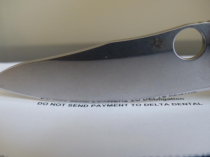

I have been sharpening for more years then I care to remember. I still have allot to learn, but not enough time to do so. I started out with oil stones and what I thought was a upgrade and went to Spyderco with only one 40 degree angle in the base. As time went on I have gone to Lansky system, Newer Sharpmaker 40*/30* and UF ceramic, DMT, Japanese water stones, Edge Pro, Kalamazoo 1x42 belt grinder, 8"paper wheels, Work Sharp etc. More money spent then I want to think about. I really enjoy doing this so I am not the least bit sorry.
The other day I wanted to refine the factory edge on my Spyderco Brad Southard Flipper. I started with Japanese water stones in the following order. Chosera 600, King 1000, Naniwa Aotoshi 2K, Arashiyama 6000. (used a Nagura Stone for a slurry). Then a strop with chromium oxide. Not very please with result. Could be due to experience. I then proceeded to pull out my Edge Pro system. Went through all the grits using a electronic angle guide. Strop with 0.50 and then 0.25 diamond paste. Never pleased with my results using this system. Heel of the blade and the tip have a problem with the angle staying uniform in looks . From here I went to my Kalamazoo belt grinder with X weight belts between a small opening in the plenum. Used the following progression. 240,320, trizack, 20 micron, 9 micron, leather belt with white compound and finished on a naked kangaroo strop. This produced the best edge for me in much less time then any of the other methods. Took about 5-8 minutes total. I must note that I have used belt grinders for about 40 years off and on in my work.
I am sure others here have tried multiple methods also. What have you used and which has worked out the best for you?
