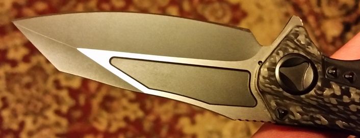

I love my Microtech Mini Matrix so much and don't want to hurt it. I read on the Microtech site that you can use REM oil, and read somewhere else that Remington makes something called Dri-Lube that is great for folders. Are these my best choices?
Also, my blade has a black ceramic coating (see pic please), is it a good idea for me to oil my blade? can it damage the black ceramic coating? I read somewhere that this should never be done, but have also heard the opposite with people saying yes do it. If the blade can be oiled, should I use the REM or Dri-Lube? Is there a better protectant available? Any insight is appreciated. Should I wax the blade instead of oiling it? Thank you for your valued input.

You are overthinking it. Rem oil or pretty much any light lubricating oil will work just fine and won't hurt your knife.

My go-to knife lube/protectant has been Tuf-Glide by Sentry Solutions. You apply it wet, wait for the solvents to evaporate, then buff it out. Leaves behind a dry film that doesn't attract dust or get gummy. Once dry, it's supposed to be food-safe.
As a lubricant, grease is probably better. But to grease the bearings, you'd need to take the knife apart...which is a warranty-voiding endeavor in the world of Microtech.
