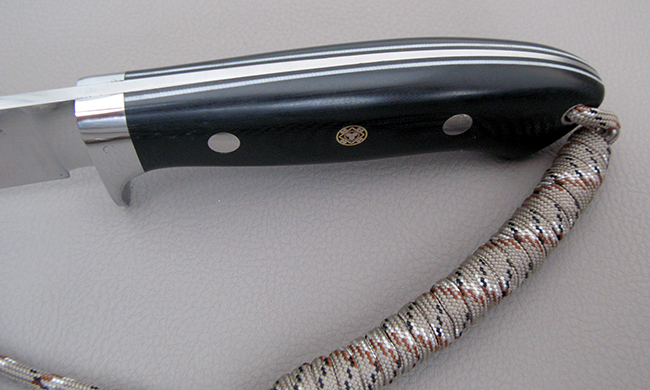

What's the best oil for coating g10 scales after shaping scales? Will teak oil work, tung oil or tru-oil? Some one said linseed oil! Thanks
Do people usually put oil on the scales when there done shaping the knife or just leave it
I have never applied oil to G10 scales. G10 is non-porous and inert so it doesn't need oil for preservation.
If you want a gloss finish then hand sand to very fine grit (greater than 800) then make a final pass on a buffer.
Here's an example of black G10 finished in this manner.
I remembered seeing this on alpha knife supplies website, thought it might be helpful. Personally never used this method, and I've only used g10 on 3 knives. I just sanded to 1200 grit and polished it out a bit with a cotton cloth. Seemed to leave a nice finish that wasn't too glossy.

The best oil for G10 is none. Buff it.

You can do it, people do, but it's a shortcut. Buffing takes a couple minutes, but it's polishing the actual material so it doesn't wash off.
