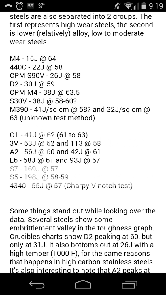

Check out Cliff's page,
http://www.cliffstamp.com/knives/forum/read.php?17,12501 /s1064.photobucket.com/user/bccole77/media/Screenshot_2015-11-10-21-19-04_zpsksuov0vh.png.html]
[/URL]
