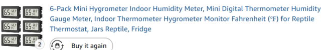

I have 2 central ac units. keep house at ~75º. Today it is 90º & 97% here in southside Virginia. My basement is driest area at about 40% RH., as it is fed by one of the central ac units and it has a dehumidifier. House has basements plus 3 floors. May need to look at 1 or 2 more dehumidifiers, or lower ac to maybe....70º?. In meantime will get VCI papers and silica desiccants. Also, as i keep each knife in its own 1" x 1" x 4" Clear Box I can place a small desiccant pack and strip of VCI paper in each box in
addition to scattering desiccant in drawers. I have a mini Hygrometer/Thermometer in each drawer. They are quite inexpensive and accurate to ±1 % or degree F. ($7.99 for 6, or $1.33 each, on Amazon).
