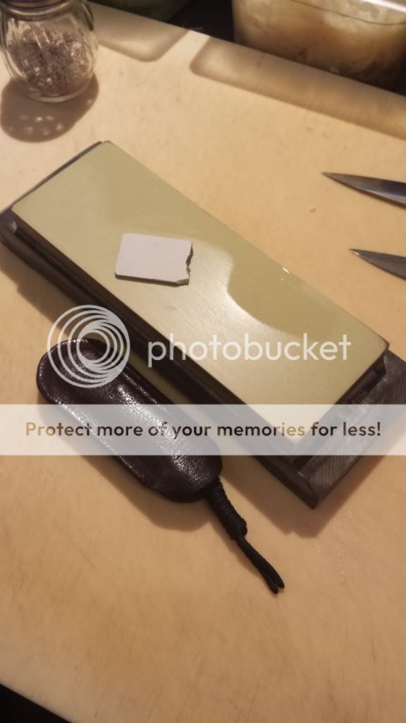

Only high grit stones (4000 and up) for my kitchen knives.
This 8000 grit stone does EVERYTHING for me
