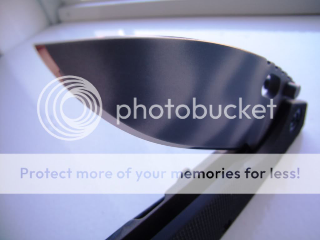

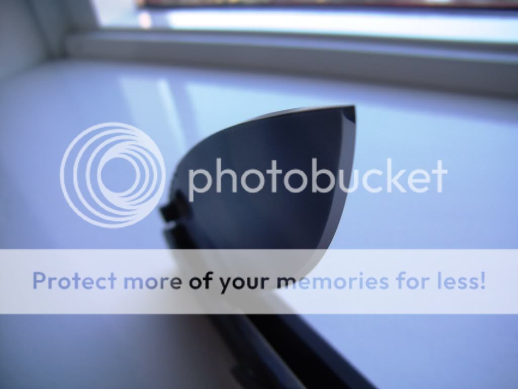

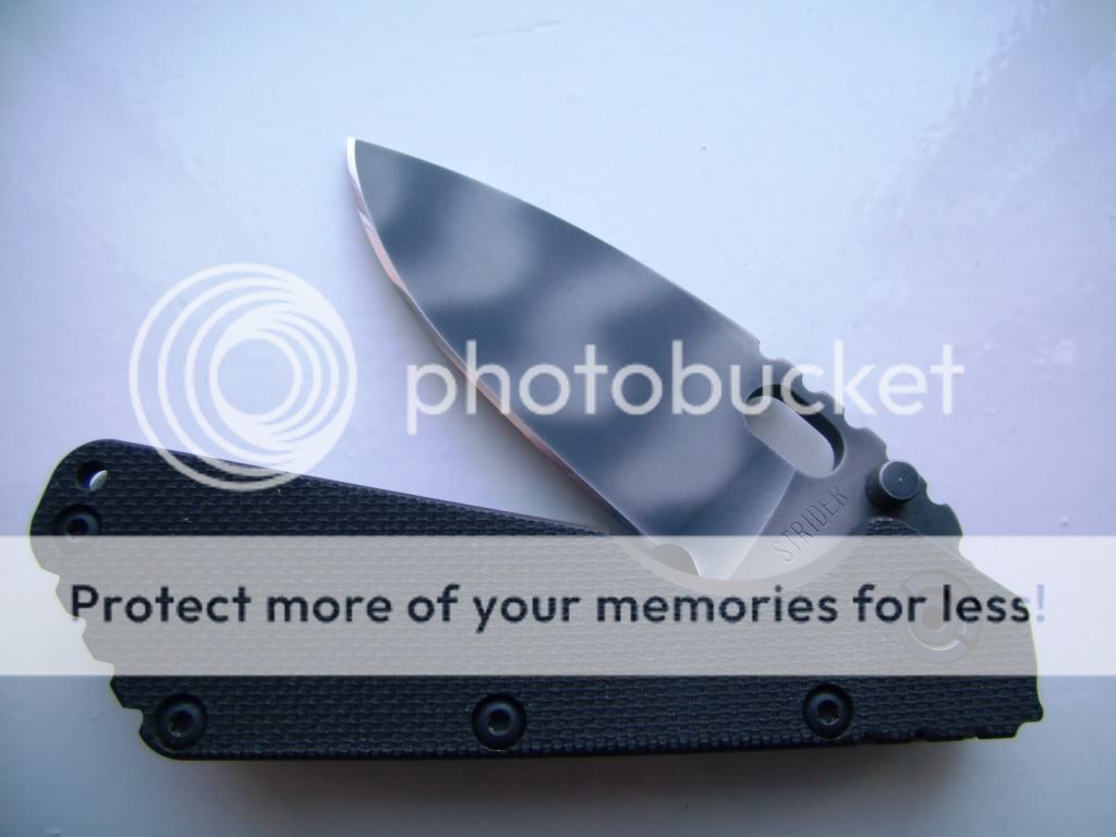

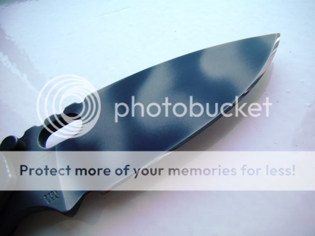

My lego SMF, done on a Wicked Edge sharpener to an edge of 40 degrees inclusive; thin enough, yet also strong.
First the standard diamond stones in gritsize 100,200,400, 600, then some wet & dry paper taped to the stones in gritsize 800, 1000, 1200, 1500, and 2000.
Finally some polishing compound on thin cardboard also taped to a pair of diamond stones.
The edge not only whittles hair, it can also cut a standing cigarette paper in half with a single slice.
And it looks good too, :D

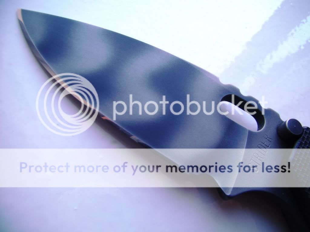

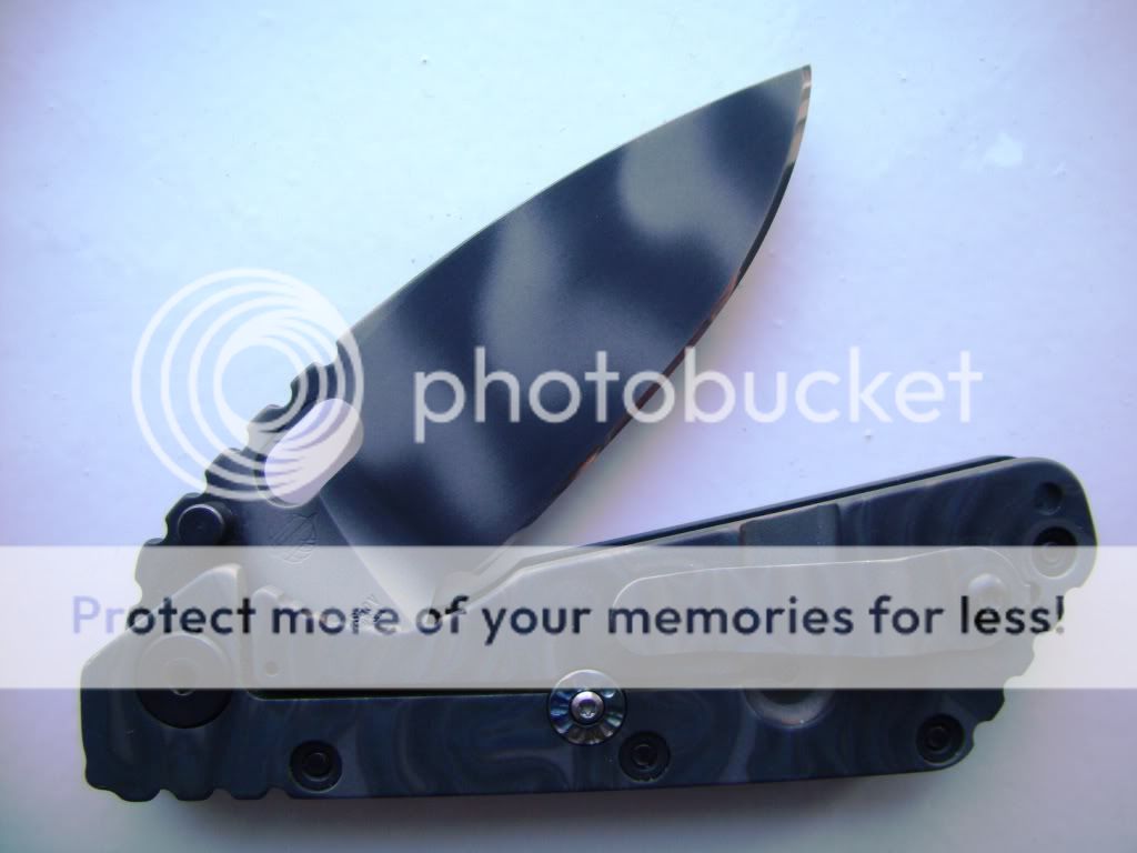

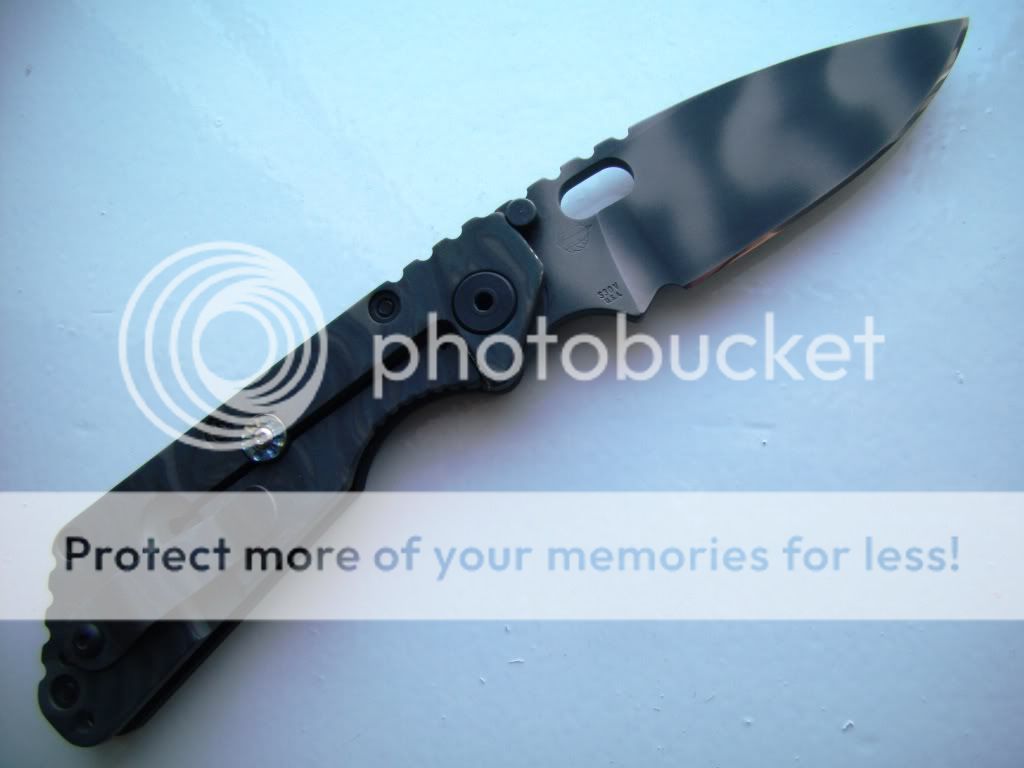

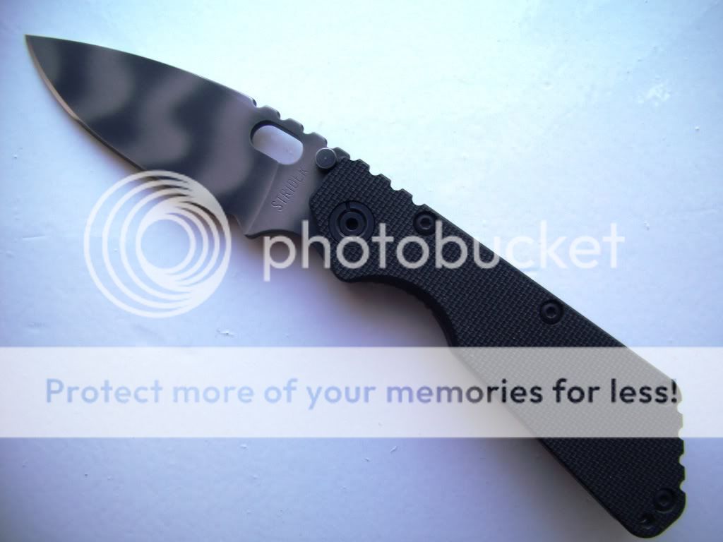

My God, it's full of stars...
On my Striders, I find that most of the time, so long as I keep up regularly, my Spyderco Sharpmaker does just fine keeping my edge in good shape. But I'm not one who pines for an extremely fine polished edge as pictured above. Though I enjoy the therapeutic nature of such work at times, often I feel that on my Striders, I'm just gonna beat the hell out of them soon anyway, so I get them shaving sharp and that does it for me.
