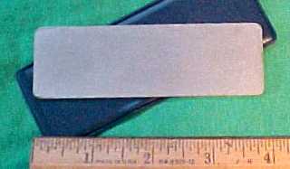

Anyone have any experience with these types?
It's a Wusthof 2899 Pocket Two Stage Sharpener.
I intend to learn the right way someday, but this looks like a fast way to
touch up the edge.
Before I made my very first knife, I didnt have any luck at putting a sharp edge on a knife at all..Well, I'm not a brand new beginner, but I have always struggled with sharpening.
Any pointers or links?
No matter the advice I received from others, I just could not get any blade sharp.
I had all the toys,,,,You name the sharpener and I own it,,,
Noting seemed to work.
Then from this forum , I found a page that talked about how to sharpen a knife.
The page talked about getting the edge of the knife to form a "burr" or a 'wire"
THATS THE KEY!
I learned that unless I was able to form a wire burr that I didnt have a chance to get a knife sharp.
Before I learned that, I didnt have a clue what a "burr" or "wire edge" was talking about...
Once you get the concept of the "burr" then all the other "toys" start to work......suddenly all the stones and V-sharpeners started to work, not because they changed, but rather i now understood what they were doing or not doing...
I knew what "I" was doing with them too....
All of the sharpeners we see for sale are great.
Sandpaper, the lansky, the V-bar sharpeners, the power sharpeners, the dimond stones, the japanese water stones, all these are great,,"IF", if you understand the concept of how to sharpen first.
If you dont understand the idea of getting a burr on the cutting edge of a knife, then no matter what suggestion we get, or what tool we try, it will just be pointlesss....the tools become just junk to us.
But if you get the concept of the wire burr, then all of the ways we have to put a sharp edge on a knife will work...
Heck, you could even sharpen a knife on a river rock too if you had too, once you understand the basic concepts...
