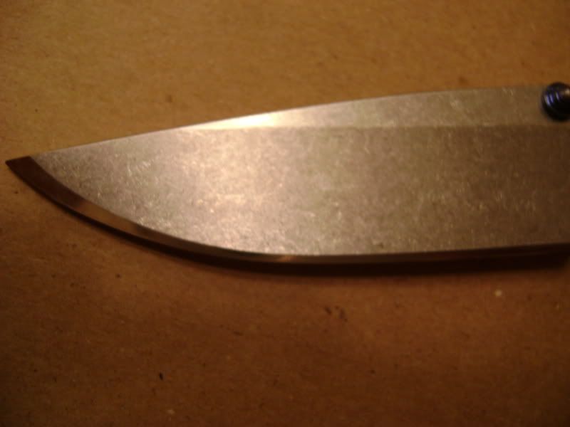

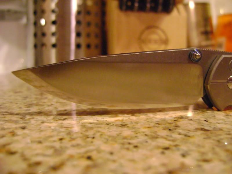

Both my Small Sebenzas did not match up with the sharpmakers 40 degree sharpening angle. They were reprofiled on the Edge Pro. ( I went a little gung ho while using the EP but I love the results) I used the EP around the 18 setting, but I did not take the blade profile into consideration and it was sharpen at a much steeper angle. (Thus the WIDE bevels)
Both knives are incredibly easy to touch up on the Sharpmaker at 30 degree. I honestly don't even have to take it to the Sharpmaker as I can just strop it back to life. :thumbup:
Here is my small 21. (My EDC)
Here is my small CGG. (Comes out on special occasions)
