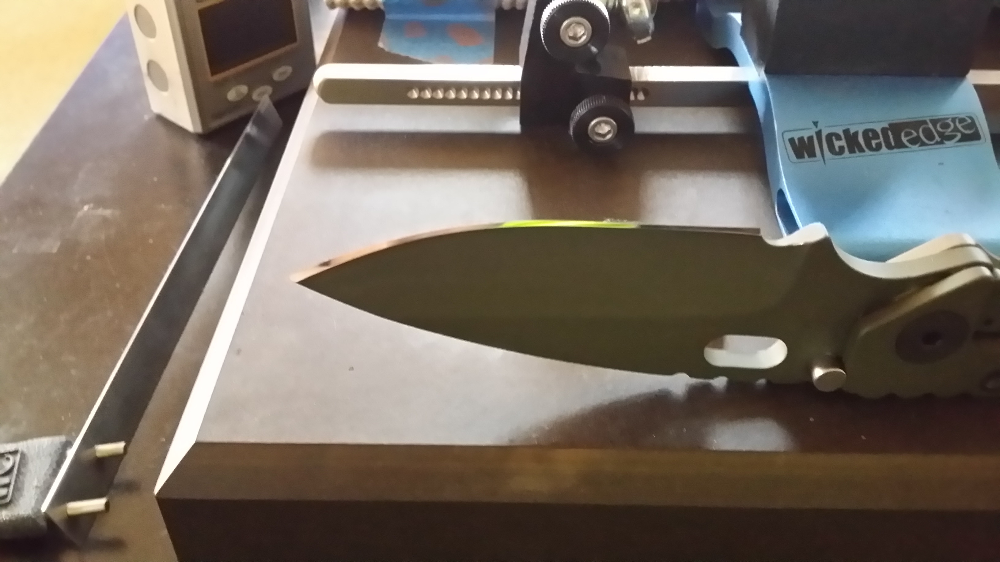

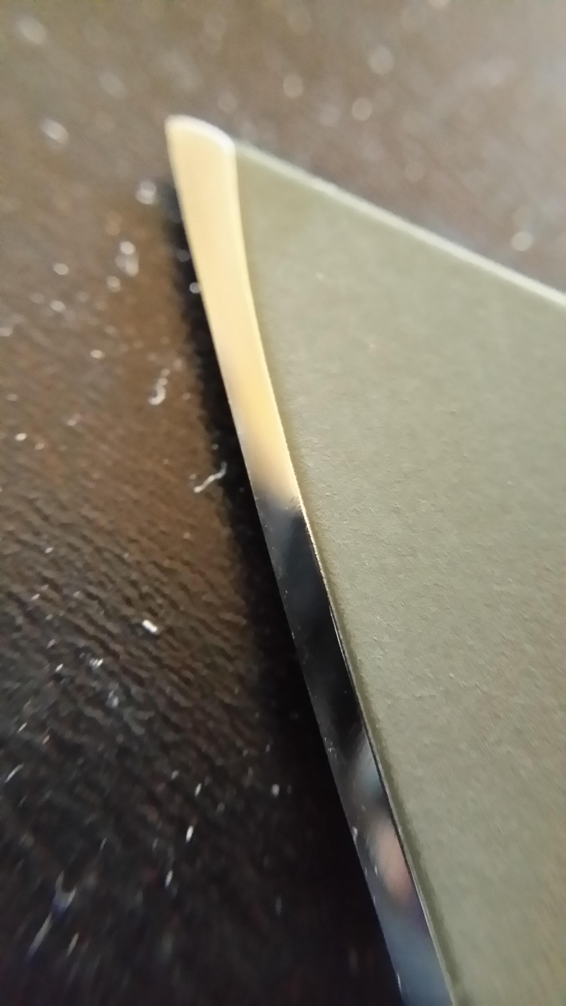

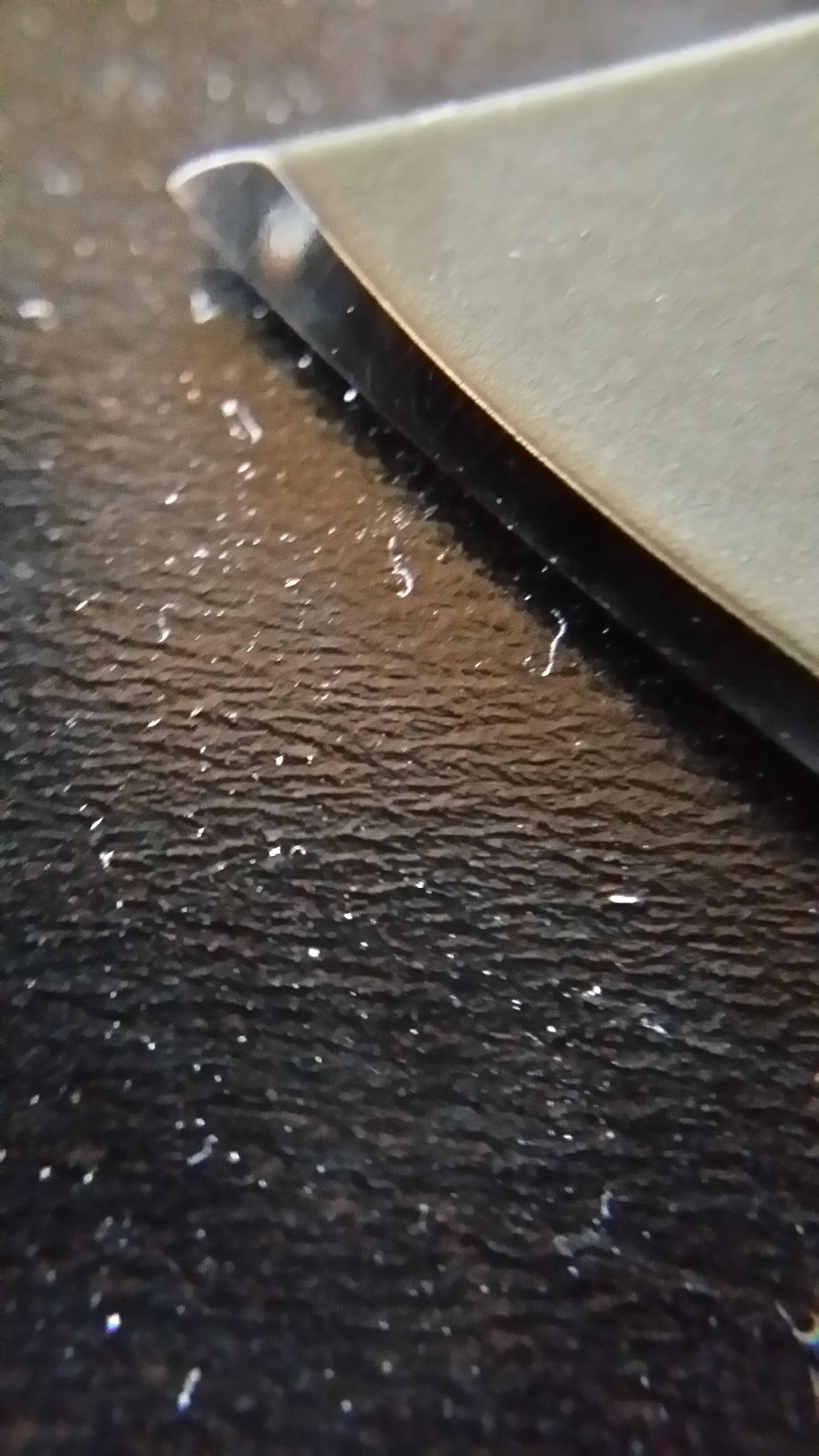

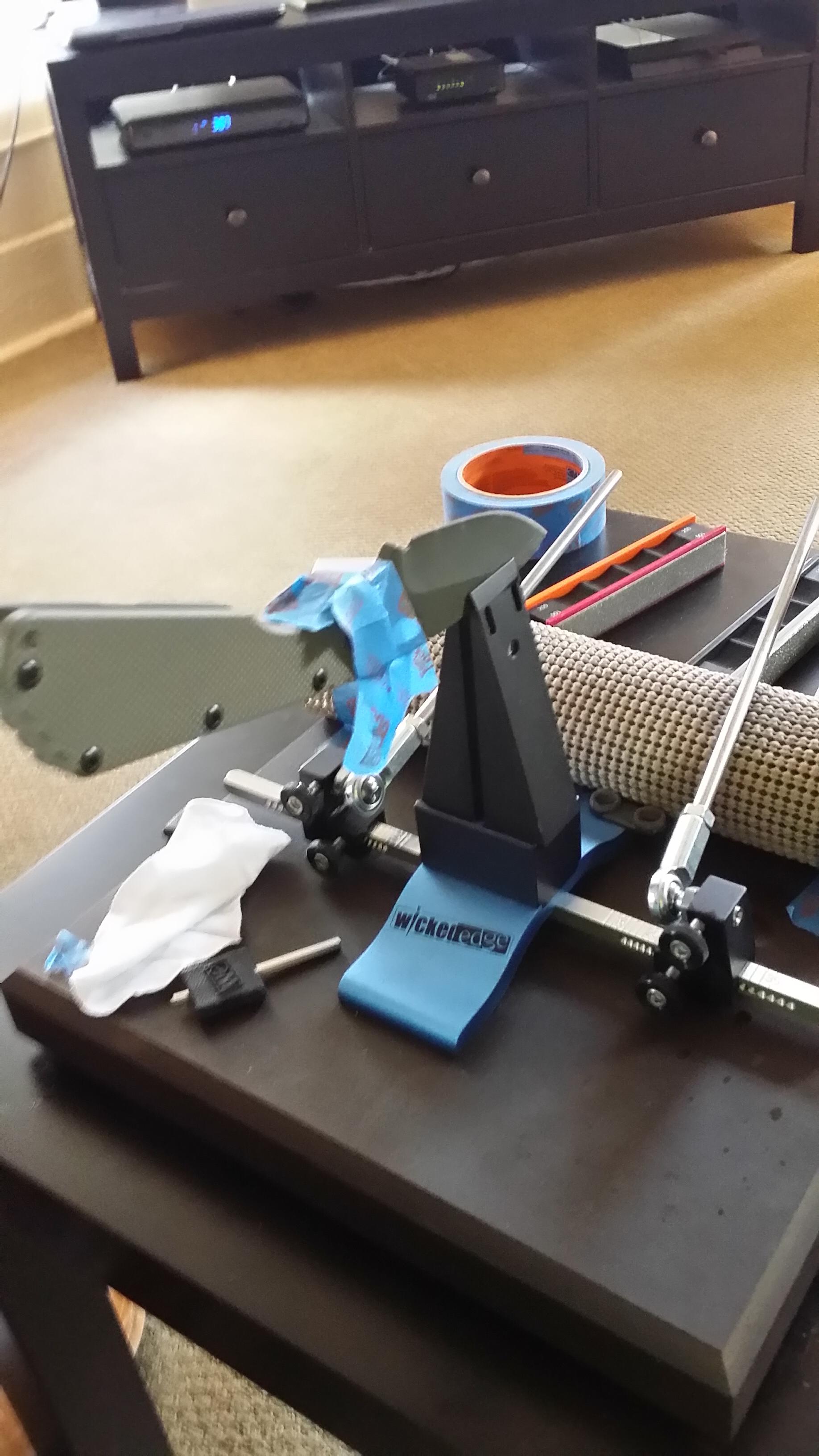

Just did this with my Wicked Edge. I mean this thing is amazing. I work in construction and I put this edge on all my knives. The only thing I change in the angle. 45 degrees for work knives, 32 degrees for my "Sunday" knives. Guys at work even say 'Why would you waste your time and spend hours sharpening it that good for work?' Here's why: After initial sharpening, it only takes me maybe 30 min to bring it back (barring severe damage). I can put the knife back in the exact same spot, and set the paddles to the exact same angle, and start from 400 grit. And 30 min is by no means rushing either. I just wish I picked it up a while ago.
