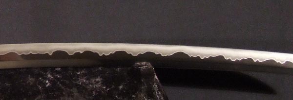

Anyway, I wanted to add that a lot of folks write off the low alloy steels as being not able to make a nice hamon but this is not really true. I'm seeing other guys getting nice lines on O1 and all kinds of stuff. I'm getting cool stuff on 5160. The lines are plain but the contrast and ability to show a gentle undulation of the line if not out and out activity is possible if you walk the right line in hardening.
Look at what Howard Clark does with L6!!
Photo and polishing courtesy of Keith Larman at Summer Child Polishing:
http://www.summerchild.com/summer.html
Any steel that can be hardened in water, oil, or salt can make a good hamon and is worth experimenting with, IMO. The simple 10XX steels are obviously the most used and give the greatest bang for the buck but low alloy steels, while not widely used can do some awesome stuff if you take the time to learn and know the steel.

Brian, most of the time I get no sori or curve with a single quench, but if I don't like the hamon and quench a second or third time, it will pull the point down (reverse sori). This is not a prob with the style blades I make, actually, I like a bit of recurve:)
Howard gets a nice hamon with L6 (and his non-traditional methods) but he gets much more activity with 1086M :)
