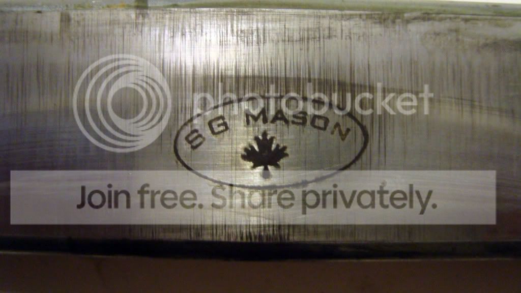

The combination of these is what I was thinking. The scales do get in the way of where I would like to place the mark, and I am getting a bit of bleed through because I am just try to get it done with a Q-tip:o I think tomorrow I am going to have to go out and by the proper stuff to make a full sized pad to etch with.
Unfortunately I don't have any scrap steel to practice on:( so I went over to the shop and grabbed a piece of tube made of an unknown steel. It is rough and may be part of the bleed through. When I make a proper pad I will try it on the home HT knife I made, its already ugly and so a few more marks on it wont make it any worse.

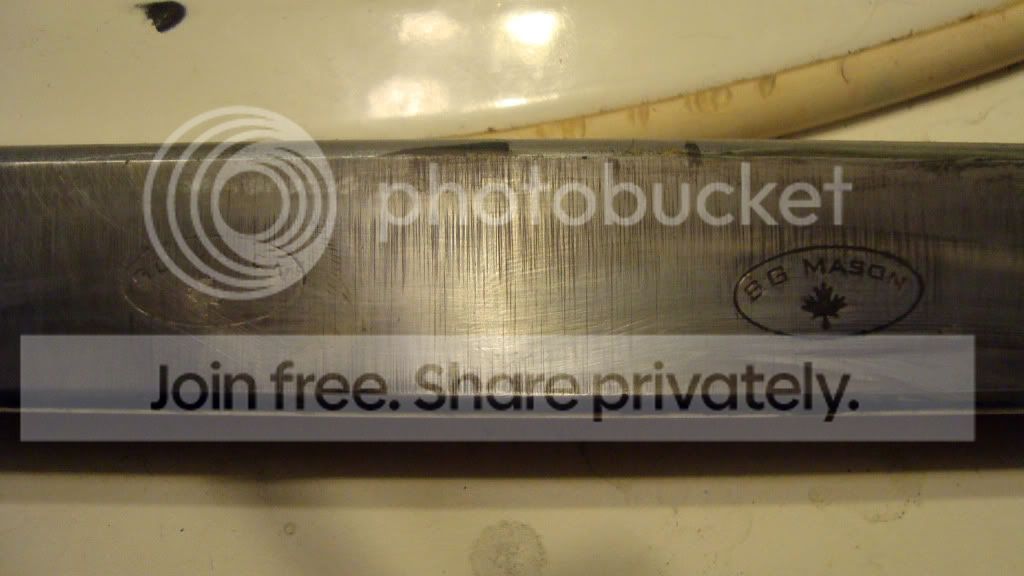

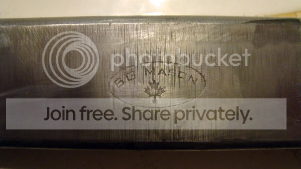

these two were done with a Q-tip and a car battery charger
It got some depth but no darkening, so I switched the leads and got this
It got both depth and darkened nicely but still had the bleed through. Both were cleaned up easily, but the overall etch is uneven on both because of the Q-tip.
Both in the same picture

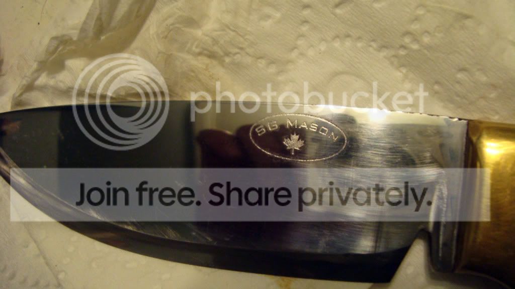

We have success:thumbup:
Thanks to everyone's input my first knife is marked
Not only is it the first knife I marked but it was on the first knife I made, hence all the scratches on it:o I have to admit that this knife was used hard over the last year and most of those scratches were well earned.
I only lightly went over the mark with some 2500 grit paper so there is a little halo in a few places. I feel that if I gave it a proper polishing at 2500 all the halo would be gone. This sucker is sharp and has already bit me good once so I don't want to tempt fate with it again. Time to finish up the new knife, etch it and polish it up to get rid of any halo.
