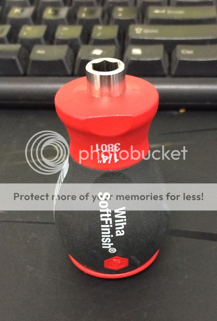

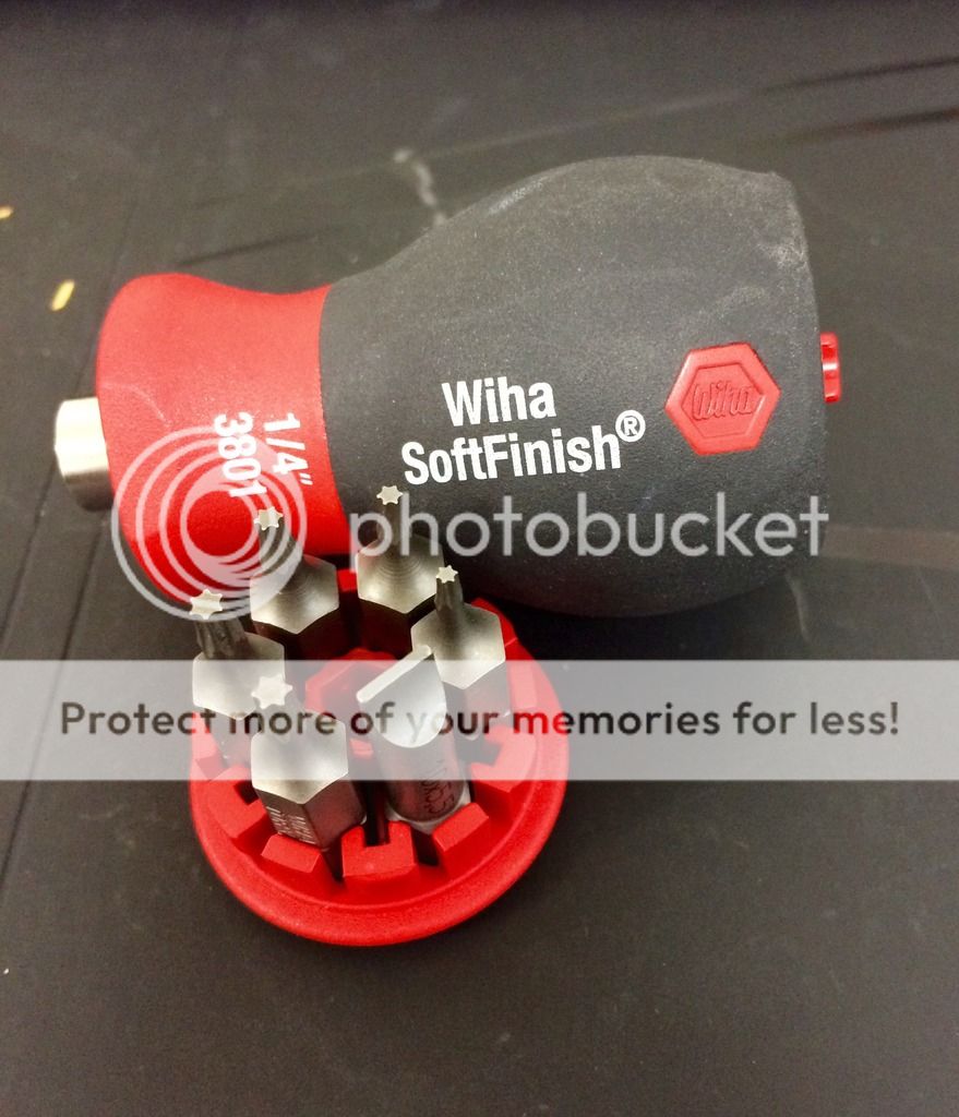

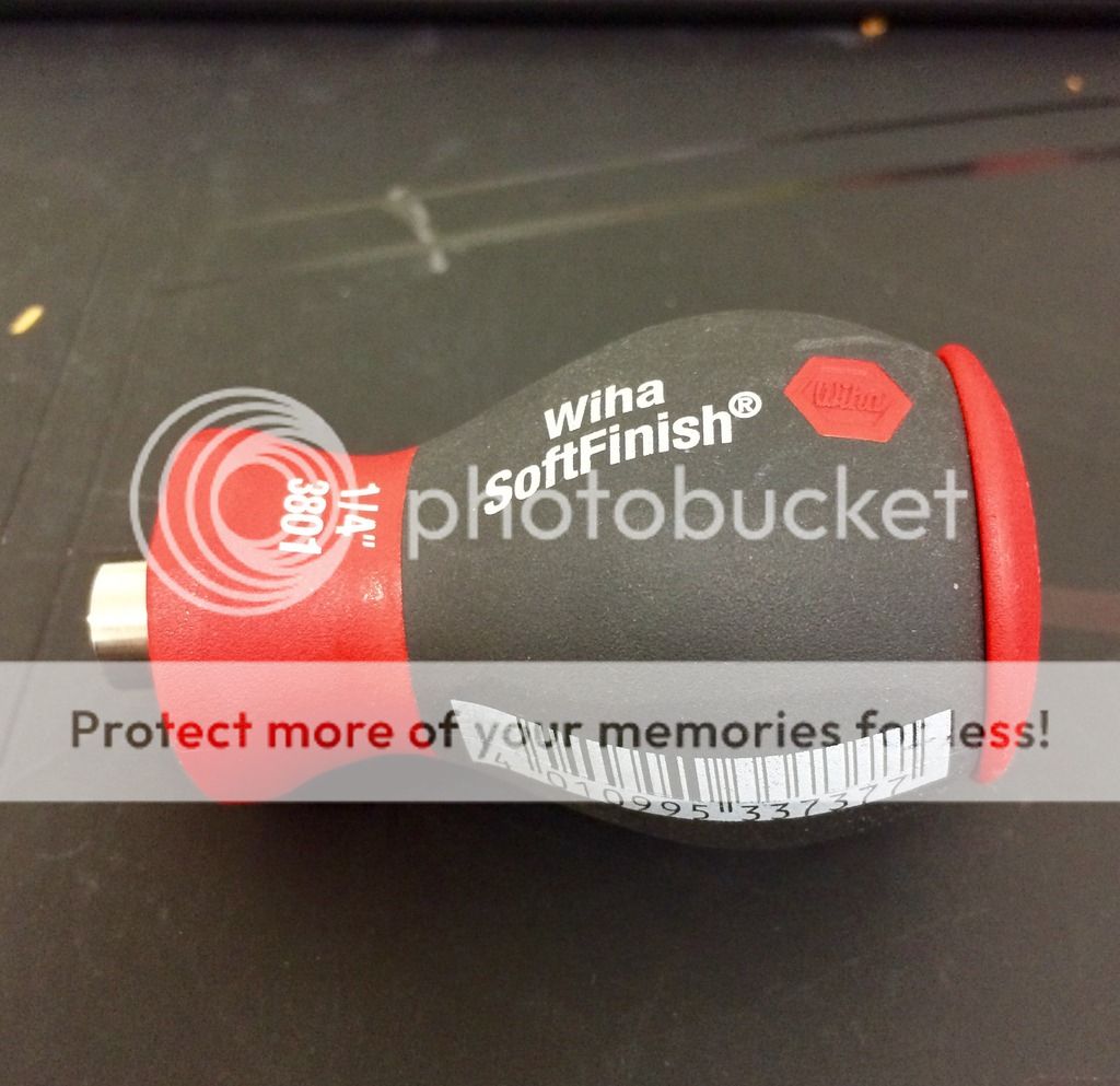

Wiha stubby is the best IMO, they also make the same one for Boker and Spyderco with their logos on it. Best of all it's a 1/4 hex size and you can use the same bid with your other adaptor/ powered drivers. And it holds 6 bits in its belly, i set it up to be T5,6,7,8,9 and a size 1 flat. Most knives use T6 on the handle/clip and T8/9 on the pivot, with exception of MCUSTA that uses T5 on the handle and the size 1 on pivot hence my set up. These bits are amazingly precise and durable, I haven't stripped any thing yet. They can be bought individually. Here is the website: www.wihatools.com
Some pics for you:
I have no problem with any, i think you mean to ask do they have a lot of "play" when inserted into the screw? No, they fit pretty perfect, I have Spyderco, ZT, Benchmade, , Boker, the screws come out nice with these bits, no shiny corners at all and the stubby handle gives you a lot of leverage, the black part is kind of rubbery, very grippy

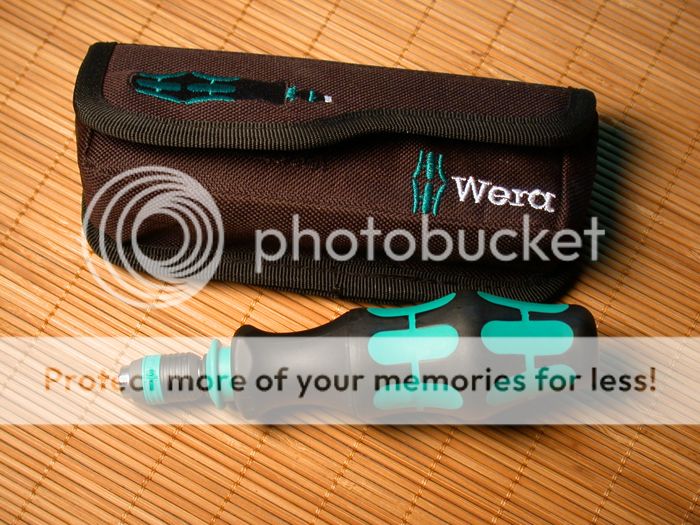

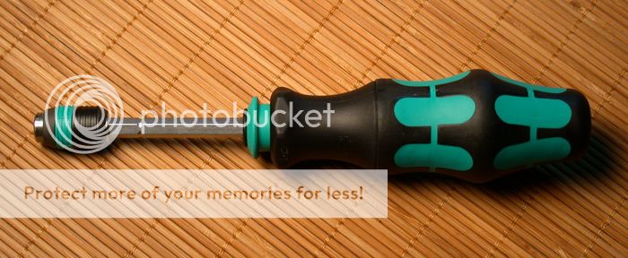

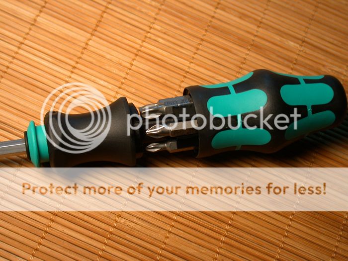

I have individual wiha in a screwdriver format. You can't get much torque to loosen something tight with those however. To get torque, I have this small portable wiha set:
For more tourque I just take the bits and put it in this:
And if that doesn't do it, i extend it like so
And if that still won't do,... The I take the bit holder out and put it on my Makita impact gun
If that doesn't get you to buy one here is the kicker
It has the press button bit storage built in!! How cool is that :)
