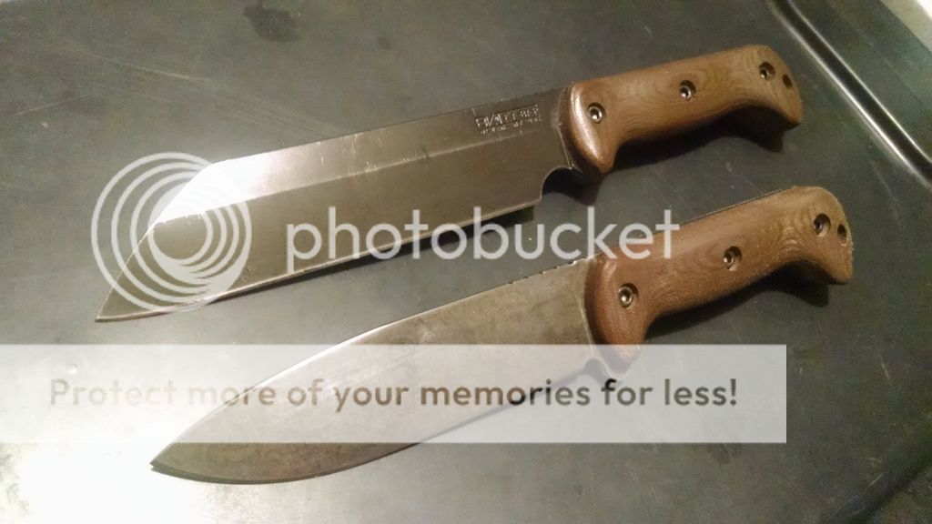

I just use mineral oil on these. It dries a bit occasionally and I just reapply. No probs beilng slick or anything at all. For some reason it looks really brown in this pic and not at all in person. Looks more OD. Maybe try a dot on the back side and see how you like it.

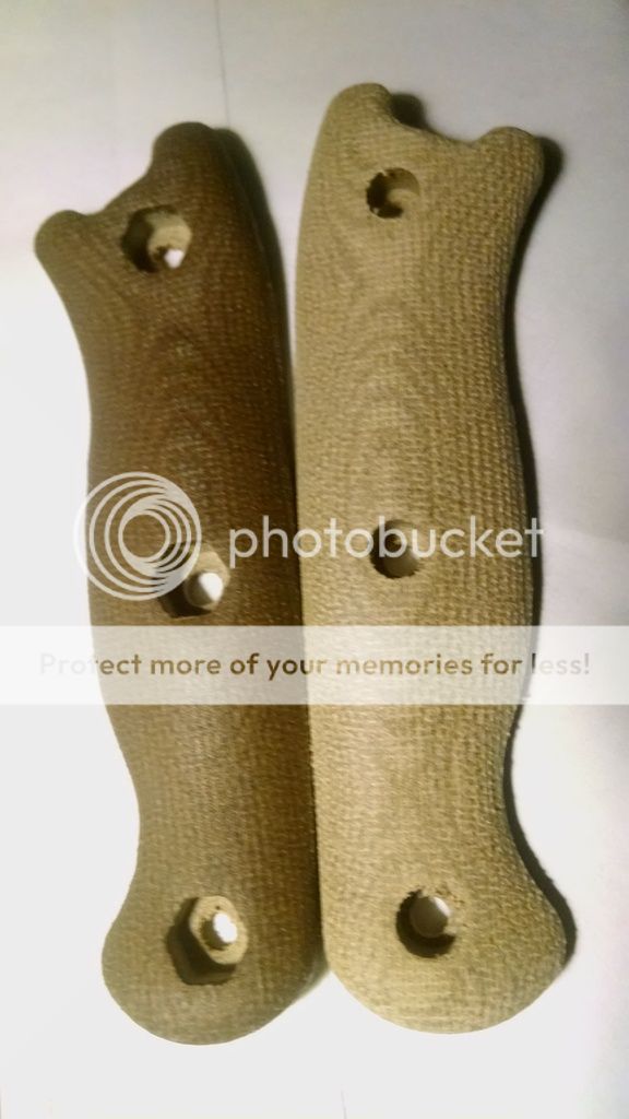

Here they are, fresh from the package. I coat my hand with a couple of drops of mineral oil then rub the scale. I immediately scrub it with a dry clean cloth and this is the result...
