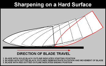

Be sure to see the "Sticky" on the Mantenance, Tinkering and Embelishment home page about Microbevels here at this LINK>>>>>
This is one hell of an obtuse micro bevel in the diagram at this link but it is a clear illustration of what a micro bevel is.
Follow this LINK>>>>
PS: page down at that second link.

This would be advanced convex sharpening on a stone,
its what I do now that I've practiced :)
Paint the edge
Work low angle, medium angle, and target angle (15dps)
Maintaining relative angles works well enough,
but if you want more exact cross section you gotta measure
Sharpening a convex recurved blade on a bench stone : Forester
