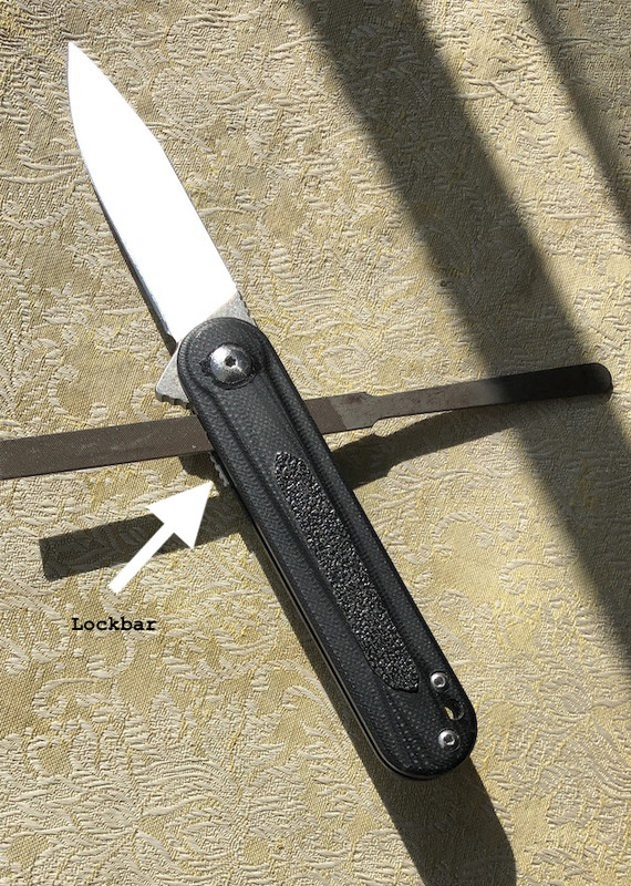

Drilling just too much trouble and hard to get right. Try inserting a small, flat file (I use a diamond one) and filing down slowly (trying flipping often) the detent bump on lock bar. Blow out filing dust with compressed air (canned air for computers). I've done this many times with excellent results. Work slowly until it flips like you desire. Add a tiny drop of oil to bearing pivot when done. Remember, the detent bump holds the blade closed also on most knives of this type.
Please excuse shadows.
I thought about this. I can easily take the knife apart and do that. BUT, a lot of them are ceramic ball, they are harder than steel!!!. You file like your way, don't you worry about scratching the liner and leave a mark?
Yes, I do occasionally scratch the liner, but never gets near the pivot bearings. For me (maybe no one else), I'd rather have a well functioning knife, perhaps with some not easily visible scratches on liner, than a knife that won't work. Just MHO.
