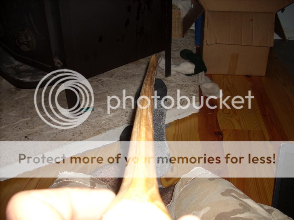

I have not had much luck straightening handles, what is the best way? Nice handle great grain just curved.
