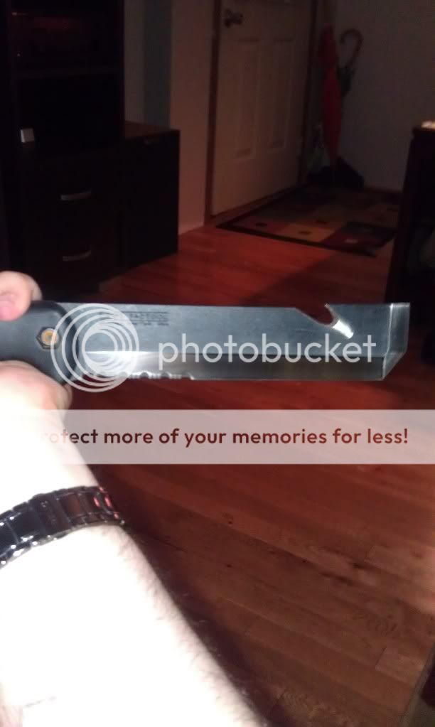

The new coatings come off very well with the stripper in a spray can. You'll still have to do some sanding but that is more to clean up the grind marks. It's one of the biggest complaints I hear when people strip it is about the grind marks, course that is one of the reasons they get coated! Tape up the portion you don't stripped, it does work. I did it to my 3.
I use the Klean Strip.. works GREAT. I just used it on my ESEE Izula this past weekend. I use the spray can type.
Lay it out on a cookie sheet or in a glass casserole dish... stand it up on the spine and spray both side with a good coat... then let it lay down and soak in. Let it sit for about 15 min and go check it... My Izula coating literally looked like an old sock wrapped around the metal... it came right of in a single piece. No scraping at all.
