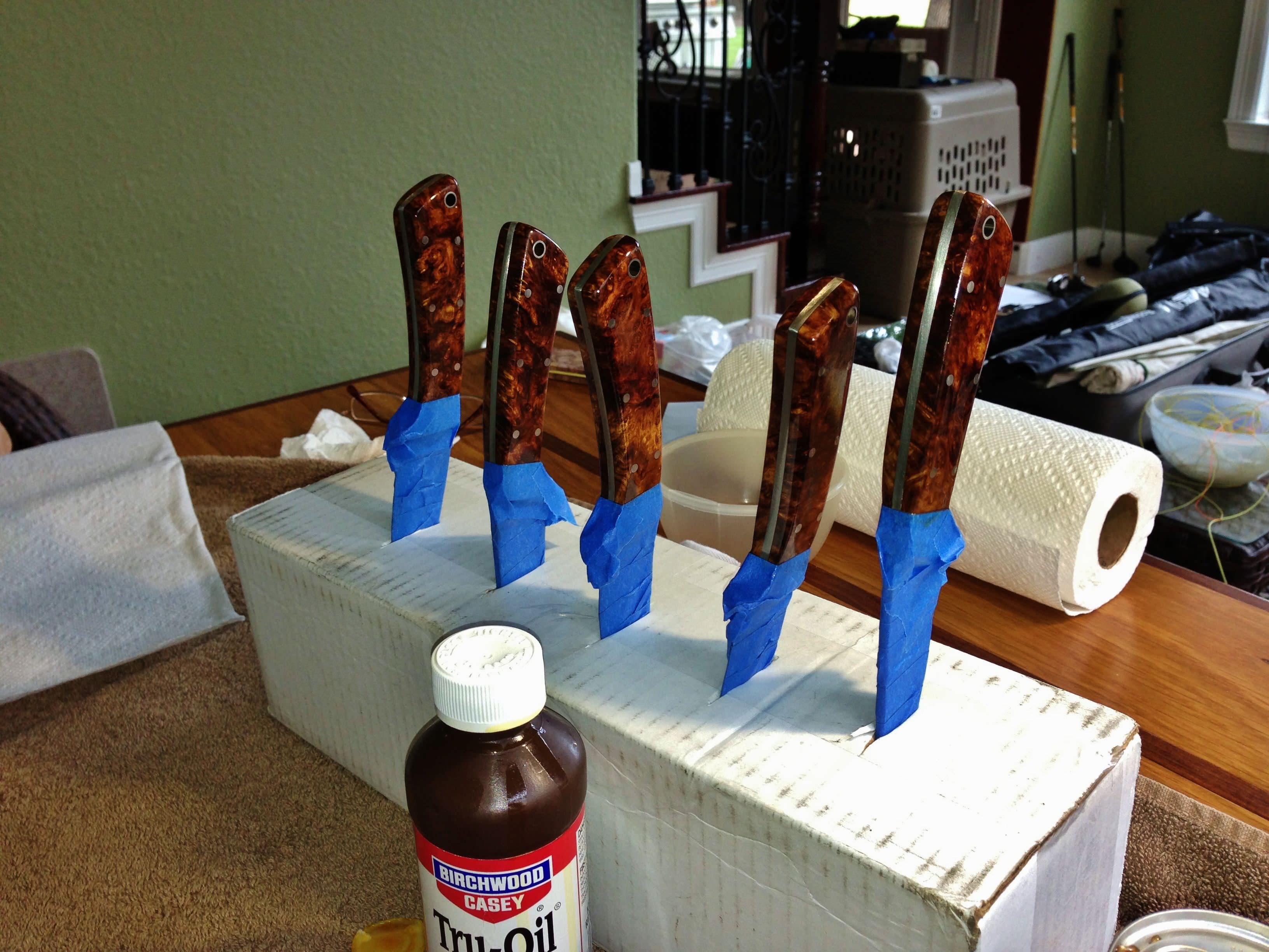

My custom wutang clan spyderco scales were looking pretty beat up. So I decided to sand and re finish them myself.
I lightly sanded all the way up to 3200cw and am pretty happy with the results so far.
I wanted to ask what's best to use before I just clear coating them with high end wood working varnish type clear coating stuff.IMG_20170727_232923-picsay.jpg
Please help and thanks Brad Cain.
I've refinished a couple of gunstocks with Tru-Oil with great results. It takes some time but after a dozen coats it yields that deep clear coat look.

If those are laminate, be careful what you put on them. Use the wrong oil finish and the glue that holds it together may degrade and the wood will delaminate. Results depend on what sort of glue is used in the laminate.
another vote for Tru-oil. Looks great and offers strong protection. There are many videos on how to apply it but I just use my fingers, rub in 6-8 coats, let dry and buff it.
I use linseed oil (several applications over multiple days), or Ballistol on my wooden handles. Both are food save and bring out the shine of the wood nicely, while not sealing it completely (in my experience, if it is natural wood and not dymondwood etc. it needs to breathe).

I have used linseed oil, and while it looks good, it takes a long time to dry. It also requires too many coats and is not especially water resistant. If water resistance is wanted, I seal with Watco and then follow with a wiping varnish, either Formby "Tung oil" or polyurethane. The Formby is not really Tung oil, but a wiping varnish and gives a shiny finish.
I don't know how this would work with the laminate you show a photo of. I would ask the maker you got it from before finishing.
