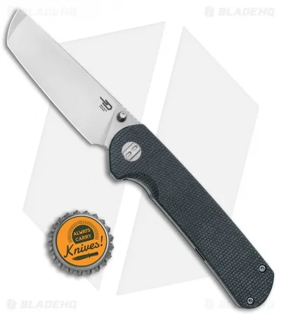

Can someone tell me what is the reason for this design? Is it intended to be a pry bar? Is the "tip" sharpened?
Thank you.
It is just another modification on the Americanized Tanto point design.
Another way that has been done over the past few years is to stretch-out the tip really large, and leave just a small section of the main blade.
You know, redsquid2 redsquid2 , that looks like a really good work knife pattern. I dismissed tanto knives as ninja toys for most of my life. But a few years ago I had a friend gift me a tanto bladed knife that had a more Americanized profile. Whoa... what a great work knife! I do a lot of carpentry/fine woodworking/repair work as part of my normal day, and I had never thought about using the tanto point for a wood chisel, a light scraper, trimming tool, etc. The knife was a POS, but it got me thinking in a completely different way.
I use a Harnds tanto a lot these days (easily searched for image) and just finished running about 700' of trim in a house. I use it constantly, all day long. I can use the blunt tip to clean out a corner that has old caulk or sealer in it, use the same tip edge to scrape a bit of errant paint spots on windows, use it for light prying to position wood before I shoot it in, and tonight I will re-sharpen to use it for fine fitting of new door locksets to trace around the existing mortises. When it has a fresh edge, it is great for slicing off splinter and bumps on sheet goods. I love having a folding chisel in my pocket. I use my CS SR1 tanto the same way.
Instead of a fighting/traditional tanto point, the blunt point works great, and I still have plenty of blade to shave off a bit of wood here and there to get the fit I want for wood working.
