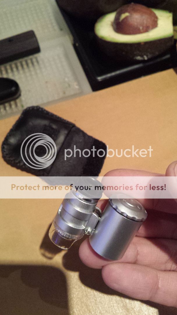

Make sure you include magnifying glass of some type.
THIS is one of the best $7 i've spent on amazon in terms of sharpening equipment. definitely get yourself a lighted loupe.
