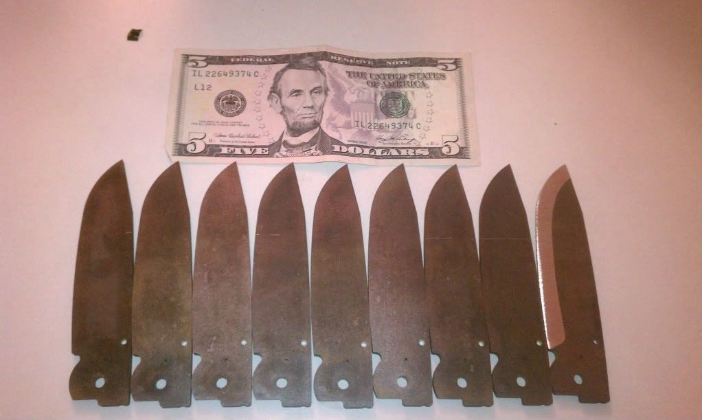

Here is what I am up against.
Hell just get a piece of flat bar and drill a hole for the pivot and put in a 1/4 dowel steel pin for stop pin and screw the blade to the flat bar as tight as you can. THe pin will keep it from moving while grinding.

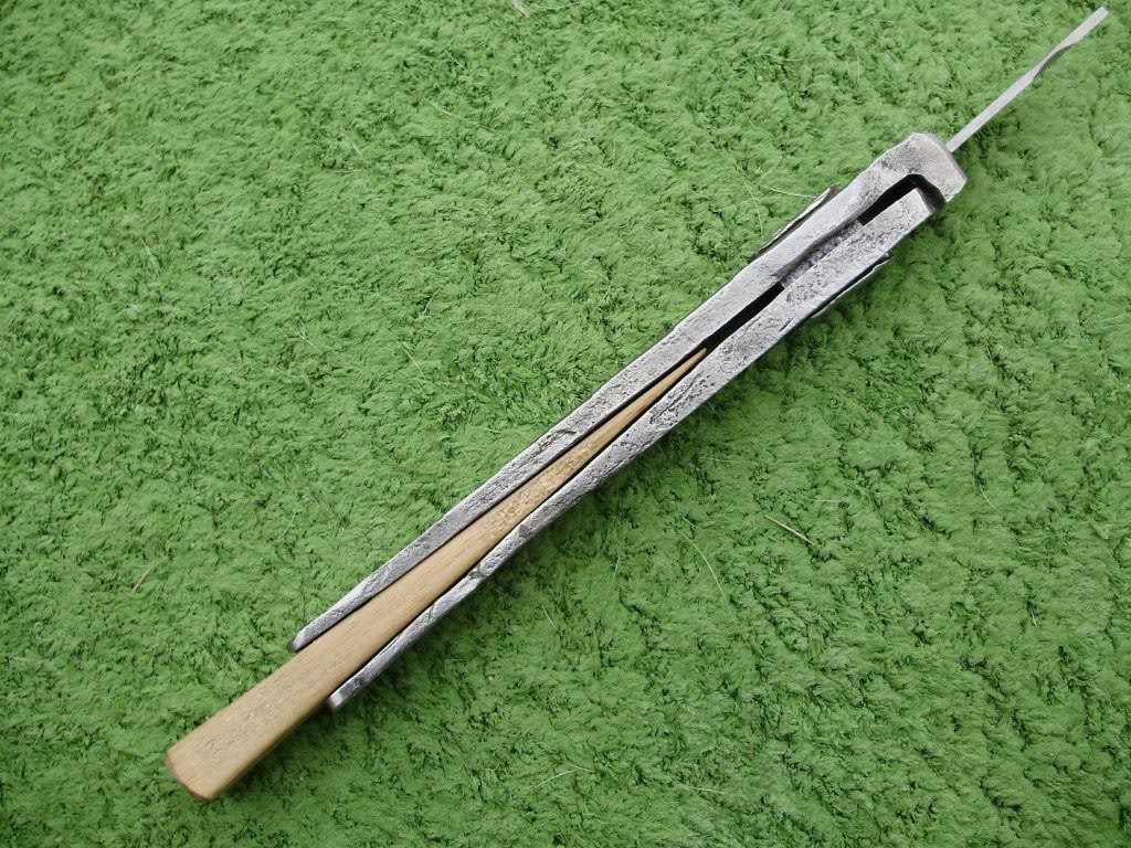

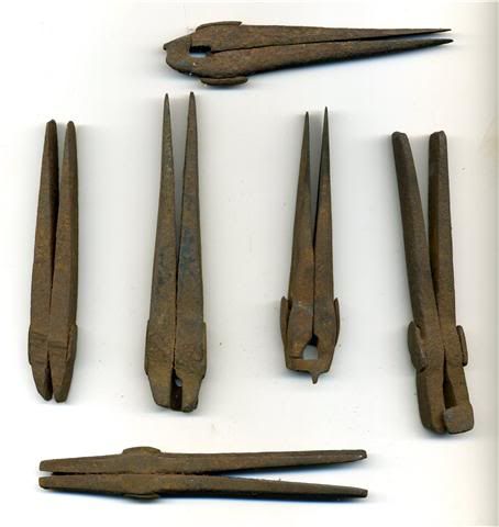

Photo's of a grinders clamp, modelled from a sheffield museum piece
EDIT: And some older models
[/QUOTE]

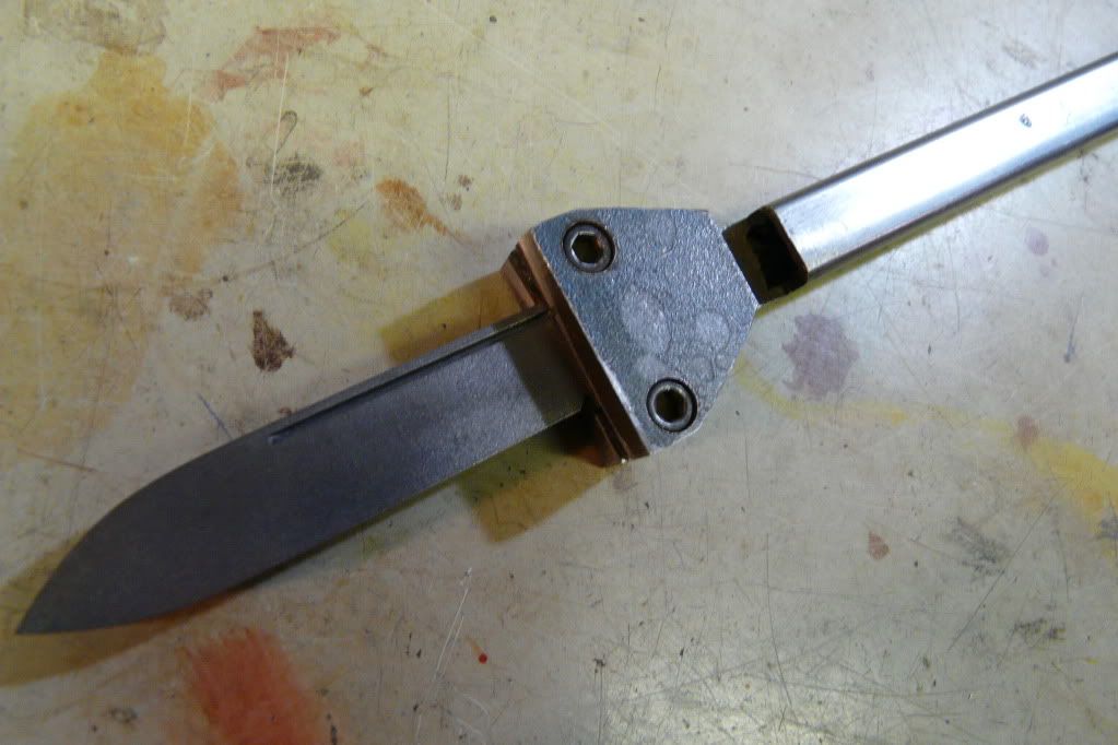

Here's my approach. Scribe a center line and clamp in the fixture. This also keeps the plunges even.
