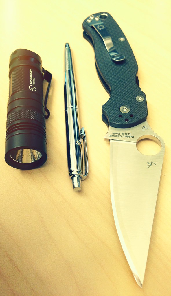

Pretty has never helped cut anything. Sharp first, pretty last if at all. P.S that knife looks just fine to me.
Absolutely.
Spyderco Dude - there is nothing wrong with that edge at all. It looks great to me! Plus it looks nice and thin. I bet it cuts like a demon! Good job man!
