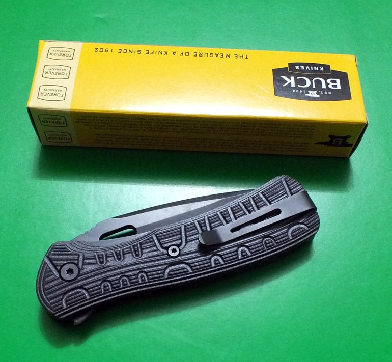

They listed this as the Pro model, but it's marked up as the Avid. Check it out.
Here's the description:
"Full Length: 19.2 CM
Blade Length: 8 CM
Blade Thickness: 3 MM
Hardness: 58 HRC
Weight: 150 G
Blade Material: 8Cr13
Handle Material: ABS
The Vantage Force boasts the latest in tactical design and innovation. An ultra-fast and smooth opening with the flipper works so quickly, you would think its an assisted opener. Using an oversized liner lock for and stainless steel frame, it provides ultimate strength and durability. When faced with a critical situation, the Vantage Force is prepared to protect in a moments notice. With a non-reflective 8Cr13 blade and ABS handle, this knife will meet the intended need for professionals."

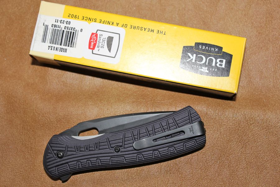

Yep, at least I'm convinced it is. Here's similar photos of the real thing that I own. You can see some obvious differences, the handle and blade pivot screws, the grooves in the handle are shaped different, there's no anvil stamped on the pocket clip and there's no white label on the box showing the blade steel type.

Wow... If you look at the blade, where the grind goes up to the thumb hole, the line ends up further towards the center of the hole on the fake, than the original one does. The Bos stamp is lower on the blade, than the original too.

The one Joe Houser just sold me this weekend at the 38th OKCA show looks like yours. Note the screws are different from the fake one.

I was looking at the counterfeit thinking, "they chose a really intricate handle scale to replicate...that's gotta be more costly than it's worth to make forgeries of" ... then I saw the item description and the ABS handle material :rolleyes:
That pivot screw always gives it away. Other than that, its a pretty close match.
Plus, notice the grooves that are molded into the scales. On the fake, the tops of them are all rounded off but on the real one they have sharp corners..
