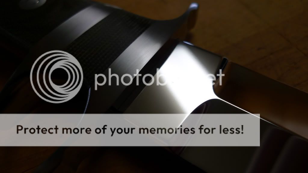

This is my first Big Bear with the Loveless-designed cold fit guard.
Here's the finished knife:
Thanks for looking. :)

Hi that looks great. What exactly is the loveless cold fit guard?
The guard is cold fitted with a Loctite product (I use JB Weld) instead of being soldered. The tolerances have to be very tight, and the guard is push fitted over the blade with the "sealant" in place. It eliminates any possibility of corrosion from trapped flux over the years.

I use the original Loveless bolt design. I like how they work ... plus it just makes sense in terms of strength. They're turned on my lathe ... all hardware is stainless steel these days.
The Big Bear was ground on a 5" wheel, it results in a stronger blade.
