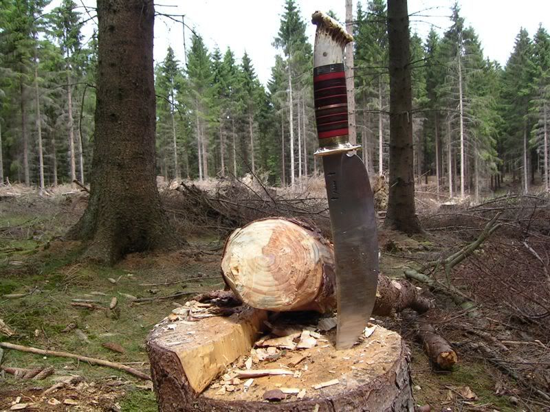

500jefferyDK: This is unrelated but who makes the Kukri style knife pictured above? I've been looking for something like that. Very nice.
Thanks again all.
The Kukri is made by Cold Steel, 5/16" thick carbon V and scary sharp. One of the best Kukries IMO. Cold Steel does not make this thick satin version any more :grumpy: maybe you can get one on ebay or one this forum.
