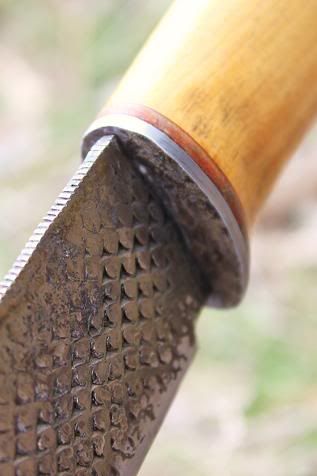

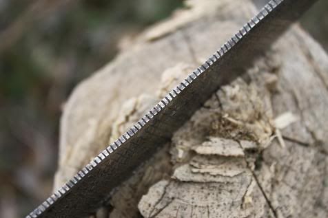

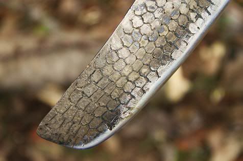

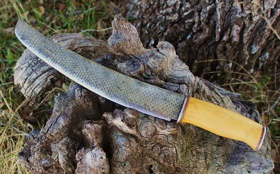

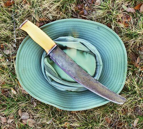

11.5" blade, about 17" OAL. Hammered mild steel bolster and butt plate, osage handle with leather spacers. Forged to shape. File serrations left on spine. About 3/16" thick.
Hope you like her!
Andy

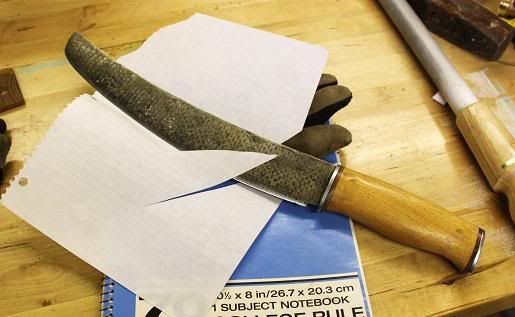

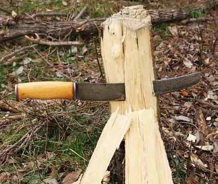

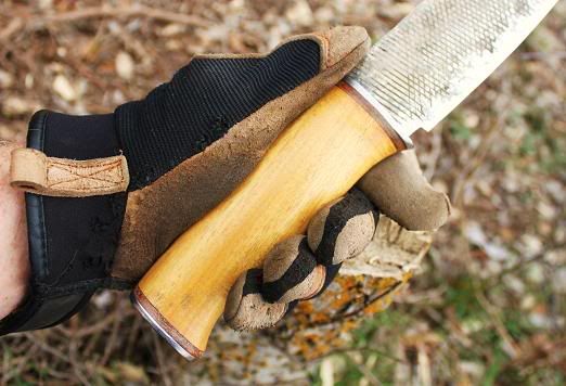

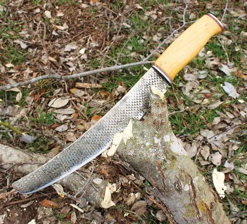

Did a little testing today - chopping, limbing, batoning.
After all the chopping, limbing and batoning was done, the blade would still cleanly slice paper -

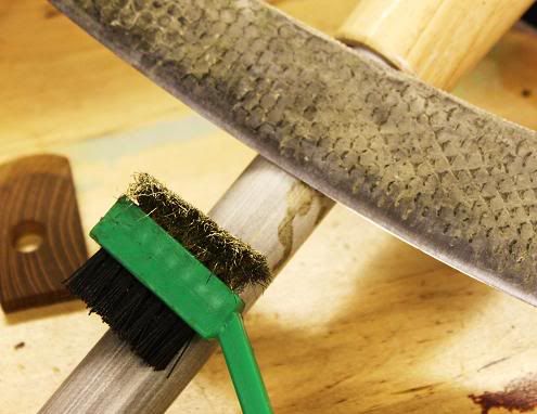

The blade is burnished with a brass wire brush, which gives it a gold/brass tint. The blade will collect some wood in the file cuts after use, but brushing the sides of the blade with a brass brush both cleans and restores the brass tinge.
Andy
