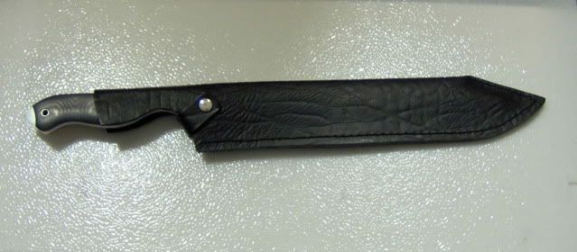

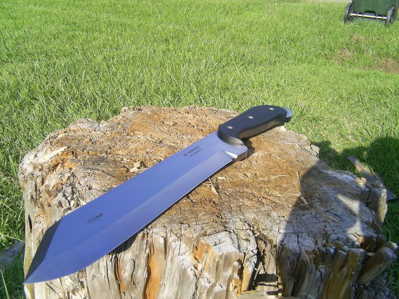

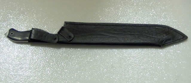

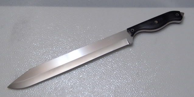

This is my Giant's knife, a variation on my XL Lacerator pattern. With 12" of blade and a full 5" in grip length this one should fit even the biggest hands. The sheath is designed to ride low on the waist and protect the handle and has a strap for retention. I'll be putting this one up for sale- if it doesn't end up in my collection instead!
Specs:
1/4" thick 154cm blade; Paul Bos heat treat @ 57-59rc
12" blade, 18" overall, 1 1/2" wide (max)

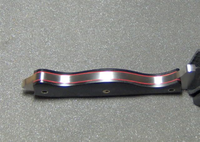

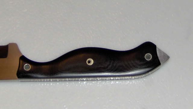

Black linen micarta scales with red liners and mosaic pin
8oz. weight black leather sheath; hand stitched
