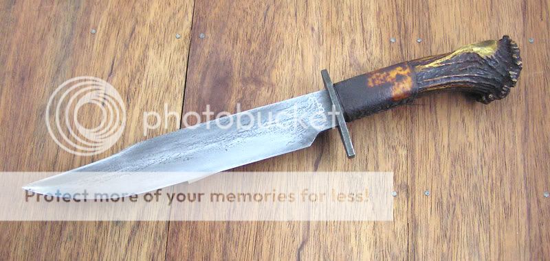

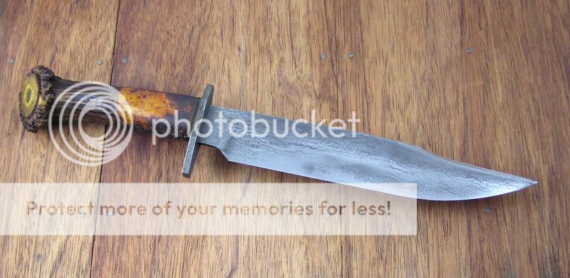

Just finished the 3rd knife in my Turtle Series. The blade was hand forged from 1084FG steel. The coffin shaped guard was forged from wagon tire wrought iron. The handle is Mule deer crown. OAL is 16-1/4". The blade is 10-1/4" long and 1-3/4" wide. Balance point is at the guard.

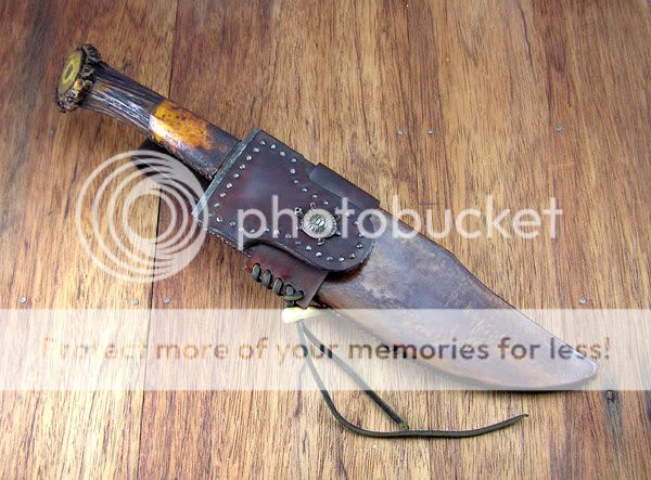

The sheath is made from veggie tan and covered with deer rawhide. The rawhide is sealed with old fashioned spar varnish. The belt loop can be removed for inside the belt/sash wear.

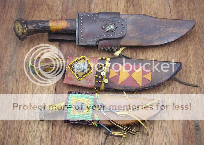

All the series so far.
Hi Mike,that is a real nice threesome,I especially like the latest:thumbup::thumbup:Regards Butch
